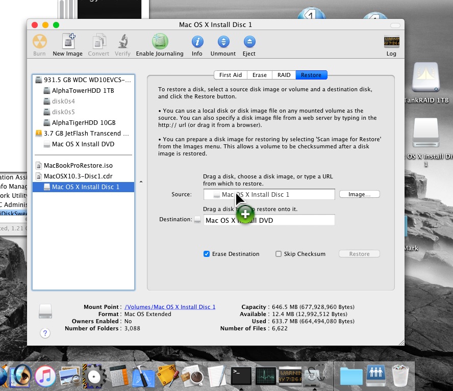

Try mounting the disk image, then using the mounted volume as the source of the restore process instead of using the image file directly. Like this;
Reactions: z970

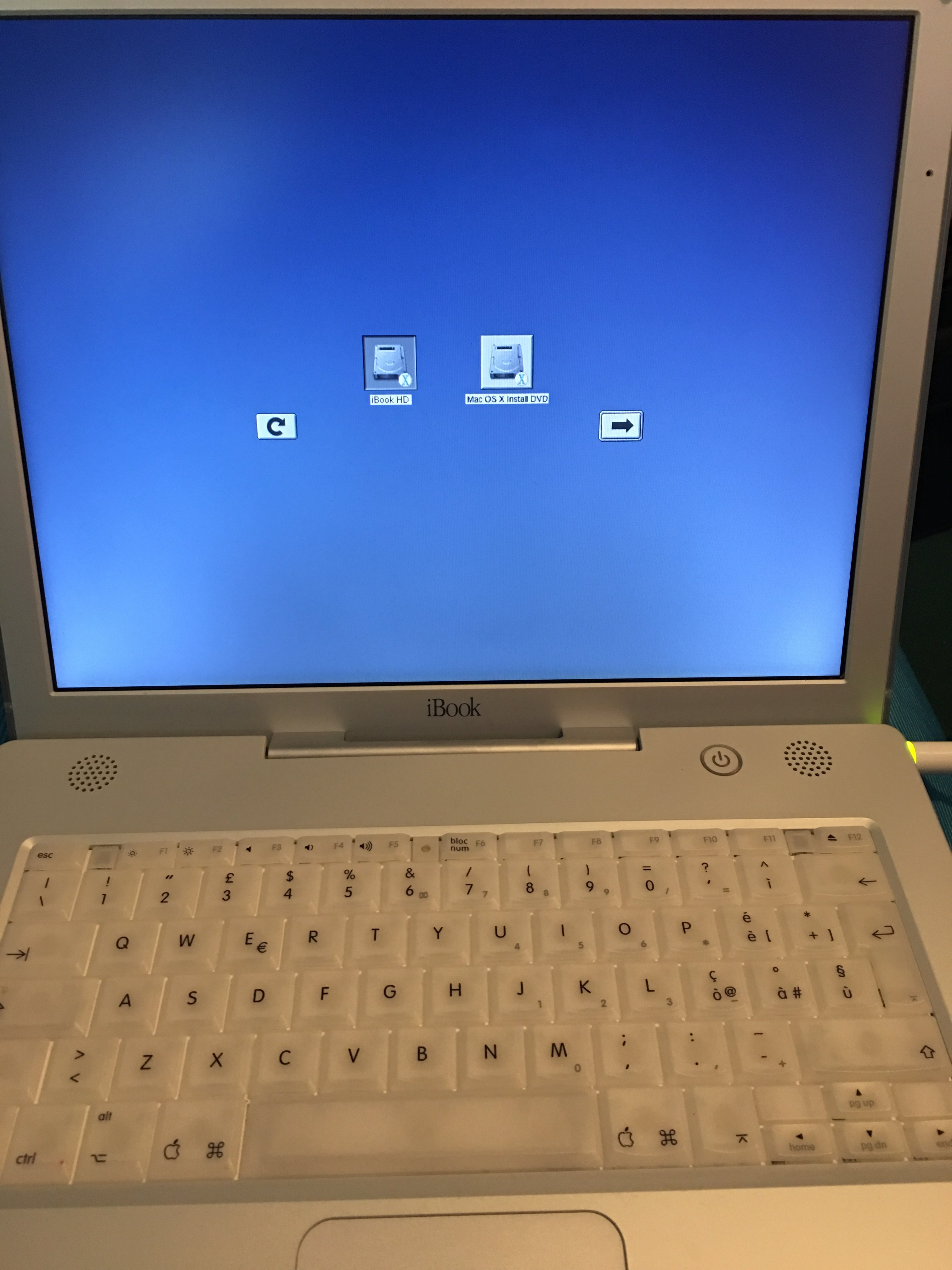

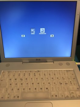

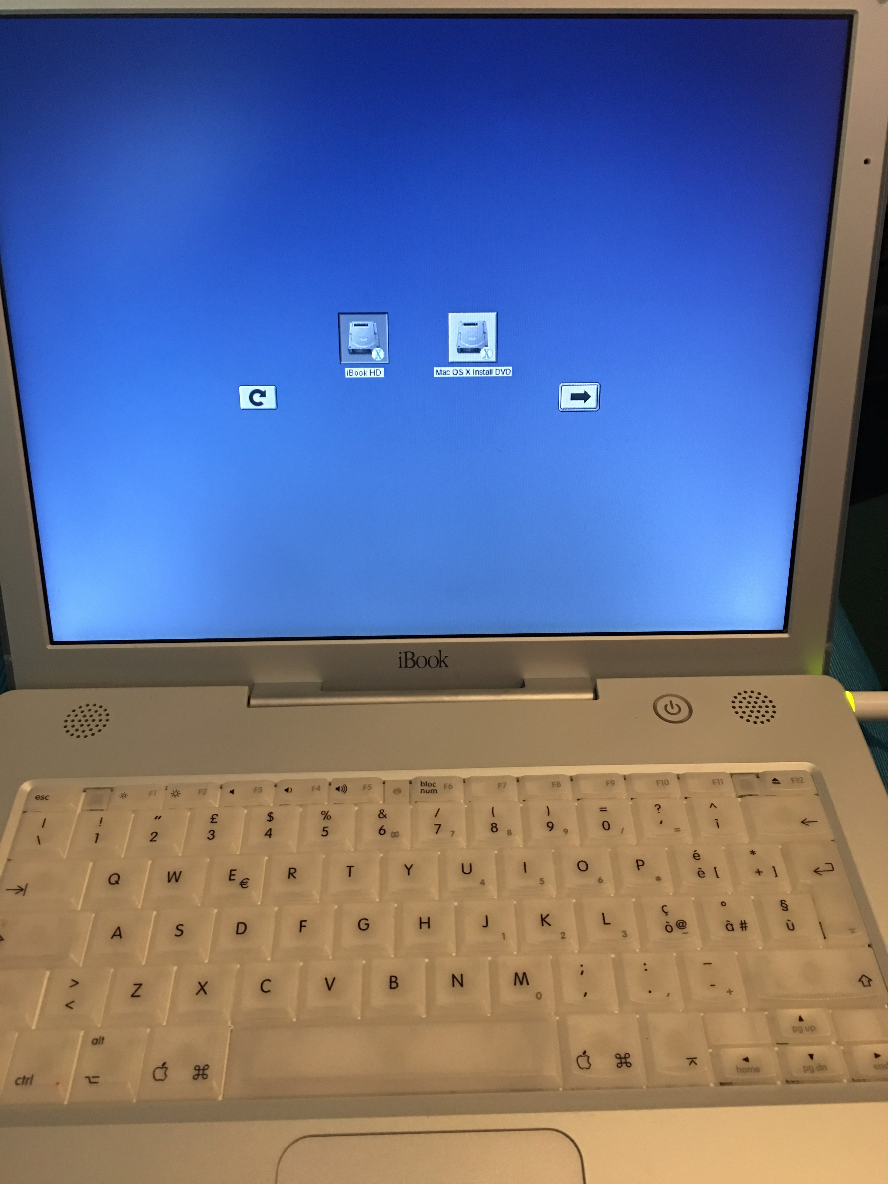

Just tried my Leopard USB drive on my iBook 14" 700MHz G3 and it showed up in the boot selector screen as you can see
If, after AphoticD's suggestion it still doesn't work my guess would be that either there is something up with your iBook or, more likely, the image you used to create your installation media from. Try again with a fresh image.
