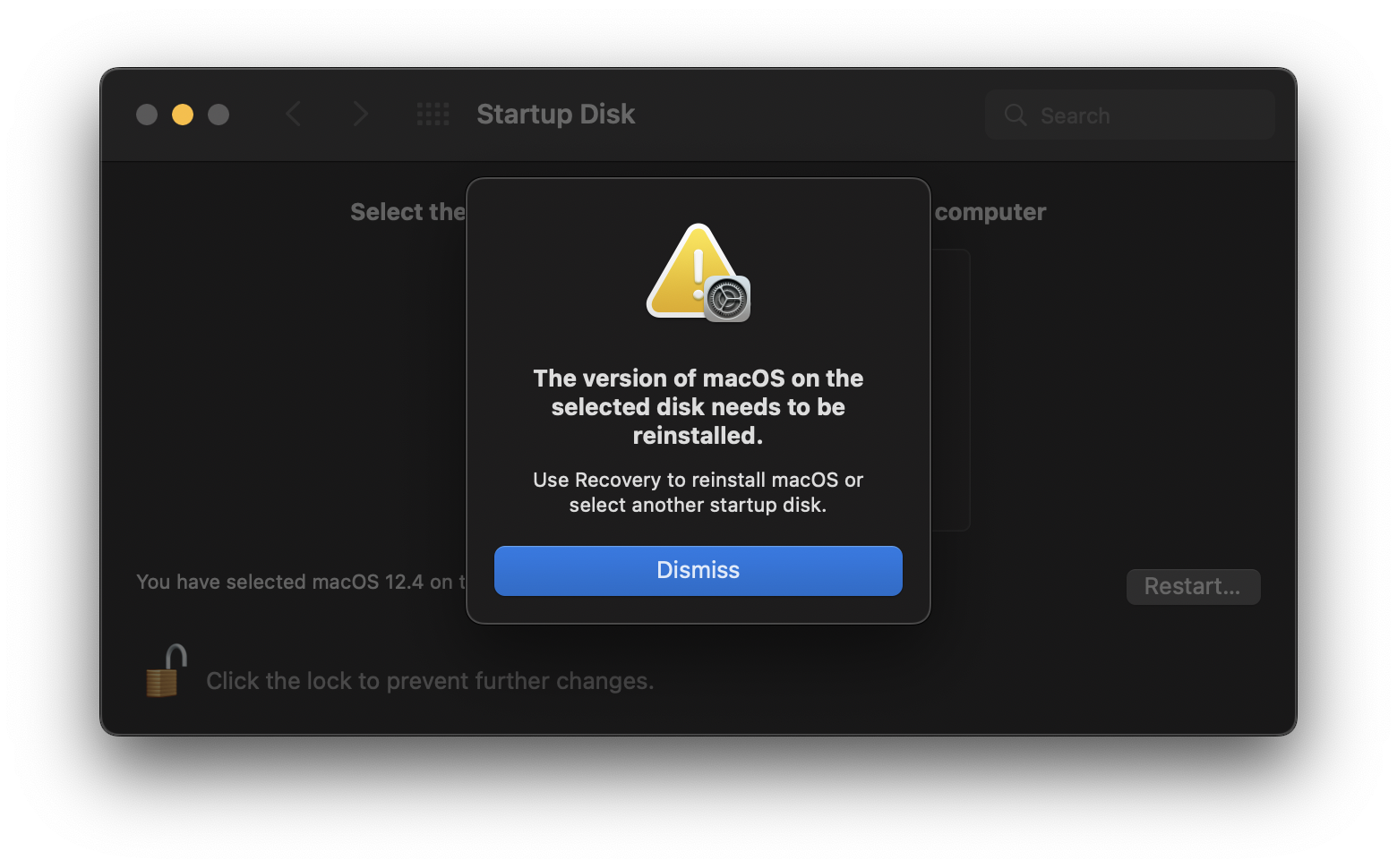

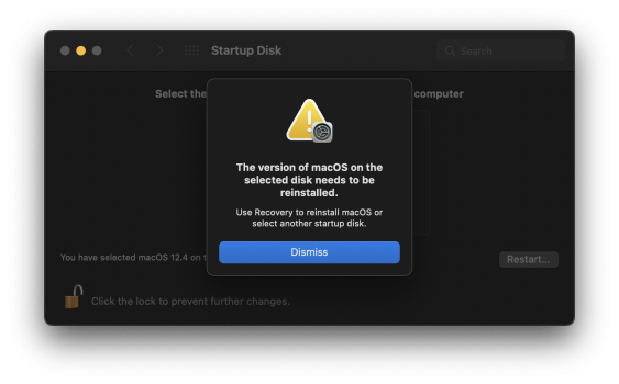

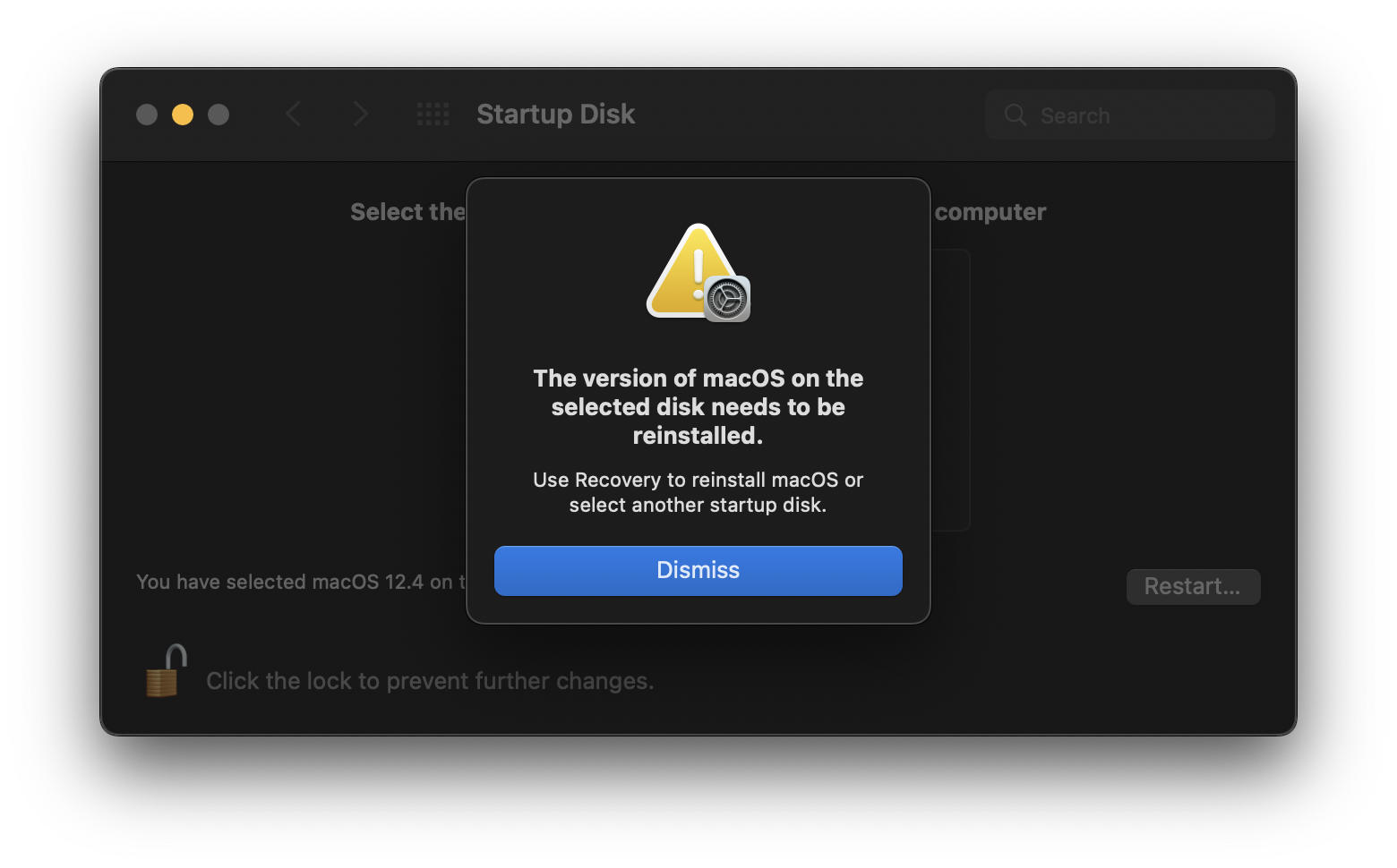

I tried this. I made a bootable external drive with my intel MacBook Pro 2019, plugged it into my 14inch MacBook Pro 2021, when I selected the startup disk, I got this error:
My intel Mac, M1 Pro Mac and the external SSD all have the same version (Monterey 12.4).

and what if u do the opposite (disk made with m1, and plugged to intel), and using a combo install file instead of downloading directly during first installation?

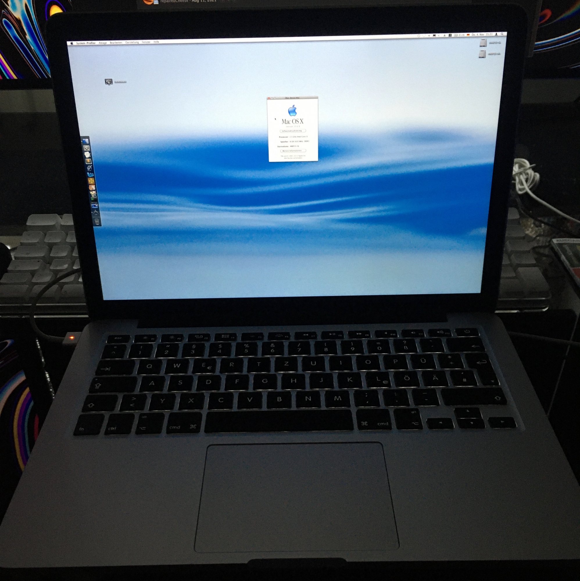

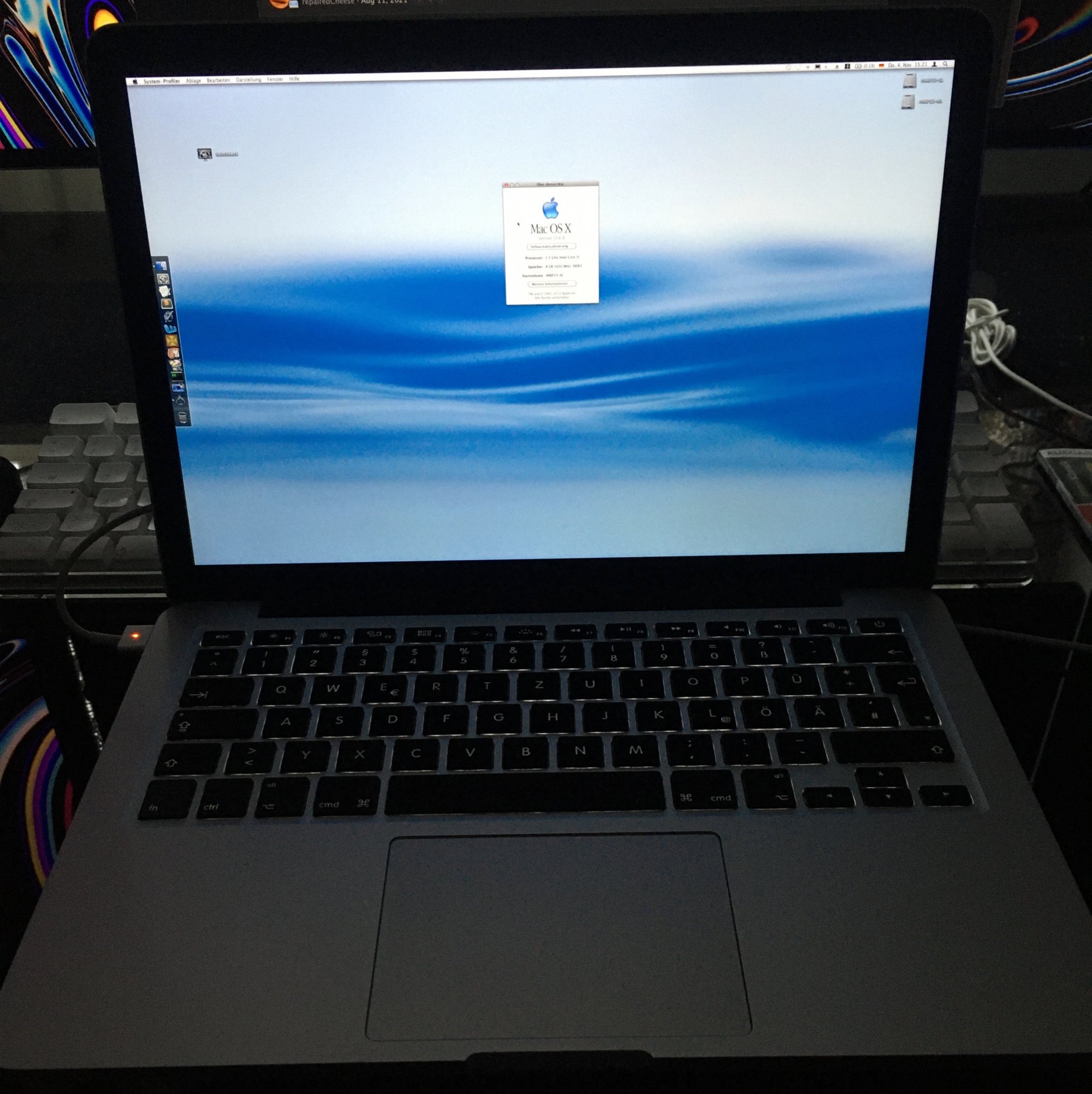

I've run
  • Mac OS 8.6 on a Titanium PowerBook G4 that shipped with 9.1.
  • OS X Jaguar (10.2) on several Macs that shipped with Panther (10.3) or Tiger (10.4).
  • OS X Tiger on an original MacBook Air that shipped with Leopard (10.5).
  • OS X Leopard on a 2010 MacBook Air that shipped with Snow Leopard (10.6).
  • OS X Snow Leopard and Lion (10.7) on a Retina MacBook Pro that shipped with Mountain Lion (10.8). (Image)
Granted, it's the luck of the draw and you can't expect everything to work, but "it's possible."

Didn't work either. Even the full installer downloaded with intel machines (Install macOS Monterey.app) won't work on Apple Silicon, and vice versa.
Another way would be install Intel/Apple Silicon OS'es on different APFS volumes on the same external SSD. I haven't tried that. But I assume what you want is the same OS running on 2 machines, instead of 2 separate operating systems on one disk, right?
