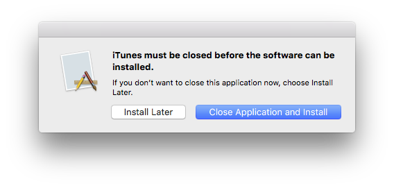

OK, I think what you explained above just happened to me: after doing a clean OSX 10.11 install (along with all additional updates thereafter) I plugged the (iOS 13.2.3) iPad Mini via USB into the Mac and started up iTunes (12.8) and the following dialog popped up, prompting me to install an update:
The "learn more" button directed me to this Apple page explaining that a new Mac update is needed whenever IOS isn't supported by it.

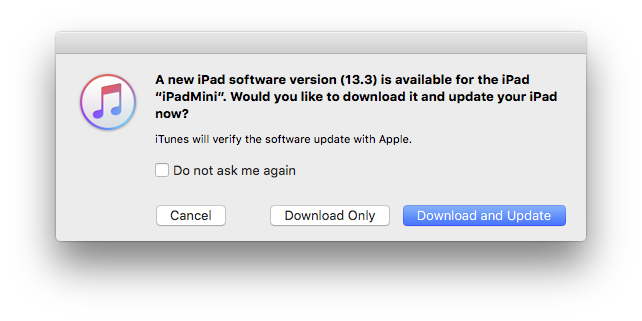

That done, I'm constantly asked (both on the iPad and in iTunes as shown below) if I want to upgrade my iPad from iOS 13.2.3 to 13.3, but I have no interest in ending up with an incompatibility issue between Mac iTunes and the iPad again, so until I find out exactly which iOS version demands which iTunes version (and thereby which OSX version it runs on) I'm holding off. Also, I've read numerous postings from people who regret upgrading to whatever iOS update came out at the time, only to find out that performance declined, the battery was drained more, other bugs were introduced and useful features were removed.
So the question remains: whenever I'm faced a new iOS update, how can I find out (provided I wait a while and read if the update is worthwhile at all) if I should go ahead, or if this means I'll end up with a demand to update iTunes which in turn won't any longer be compatible with my OSX version (and the process is irreversible)?
