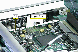

You could try resetting the logic board by pressing the button labelled S1 in the figure.
That figure comes from this article, which incidentally outlines briefly how to reset the Cube logic board (toward the end). This should have the effect of resetting your ports, and some of their settings. :)
OK. I took the bugger apart, pressed the reset button, and the IOUSB message no longer comes up in the fsck routine, BUT the scanner still crashes photoshop and Epson scan every time I use it. I've even switched it over from FW to USB, and it STILL crashes.
