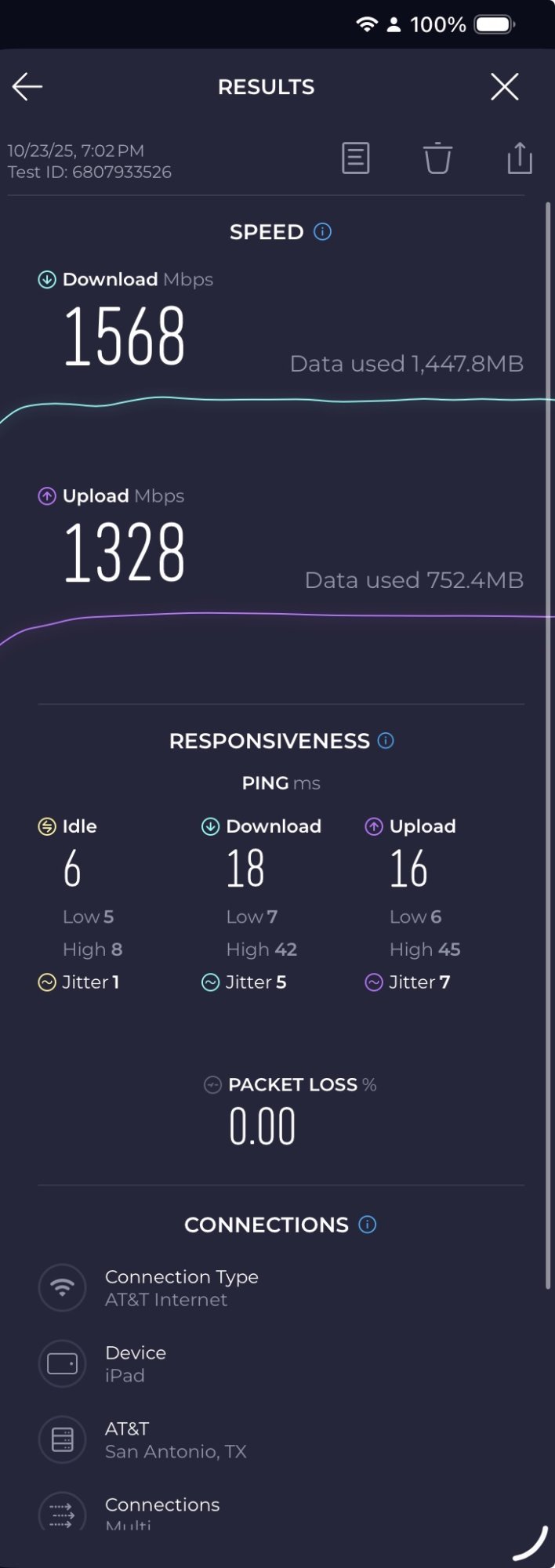

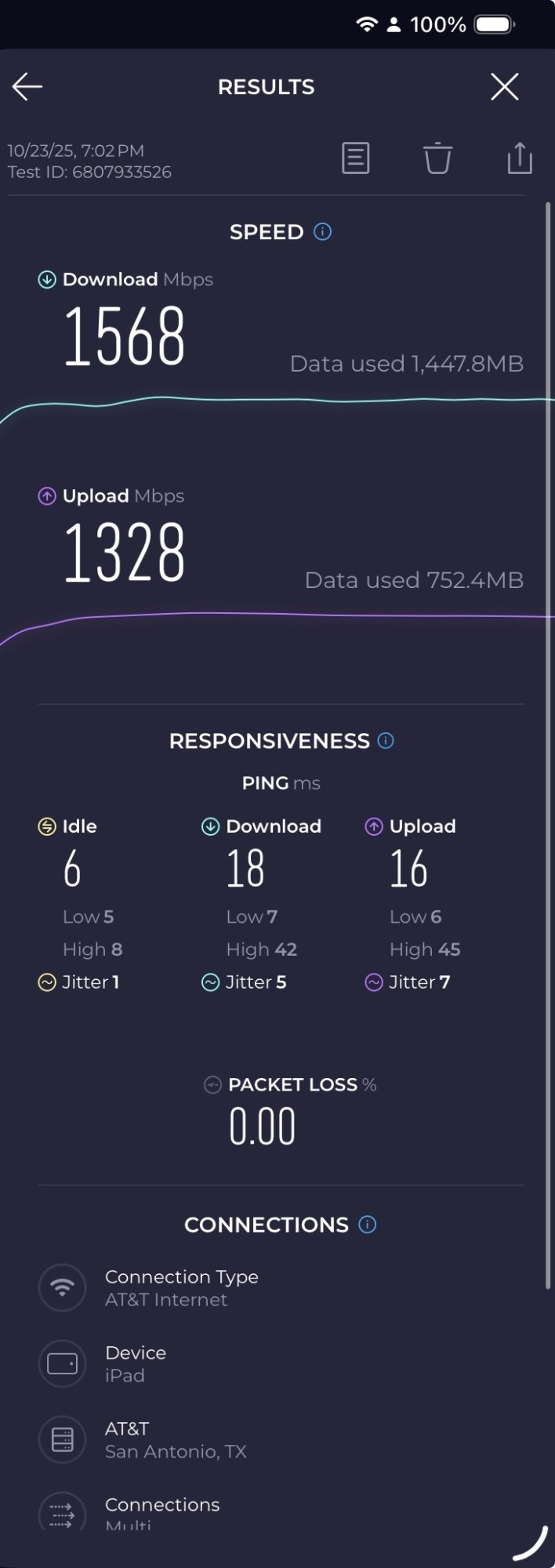

I just kept it default everything with a stock AT&T router and currently getting these speeds on 2gb fiber:
To be honest having problems with fiber recently and the modem going out, i just defaulted the settings and will keep it as is for time being. The device will try to connect to the best setting and piggy back off the other bands with a mesh network as long as the name is the same.
I personally would kept g1 and g2 the same name for that reason.
