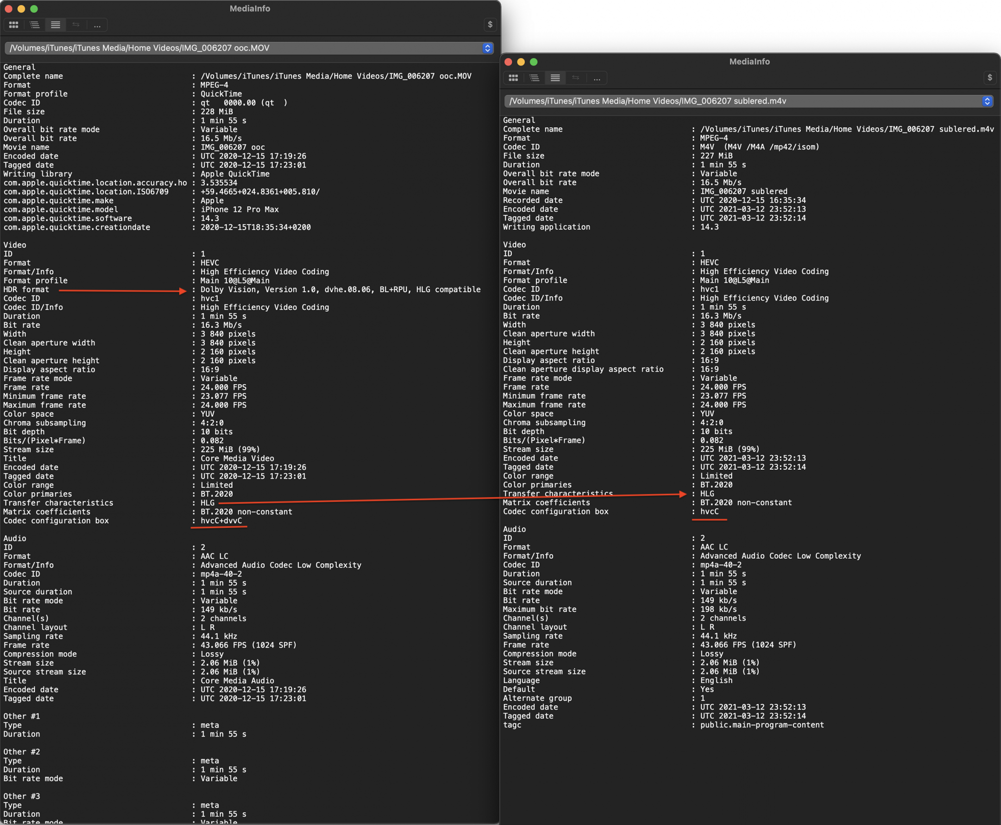

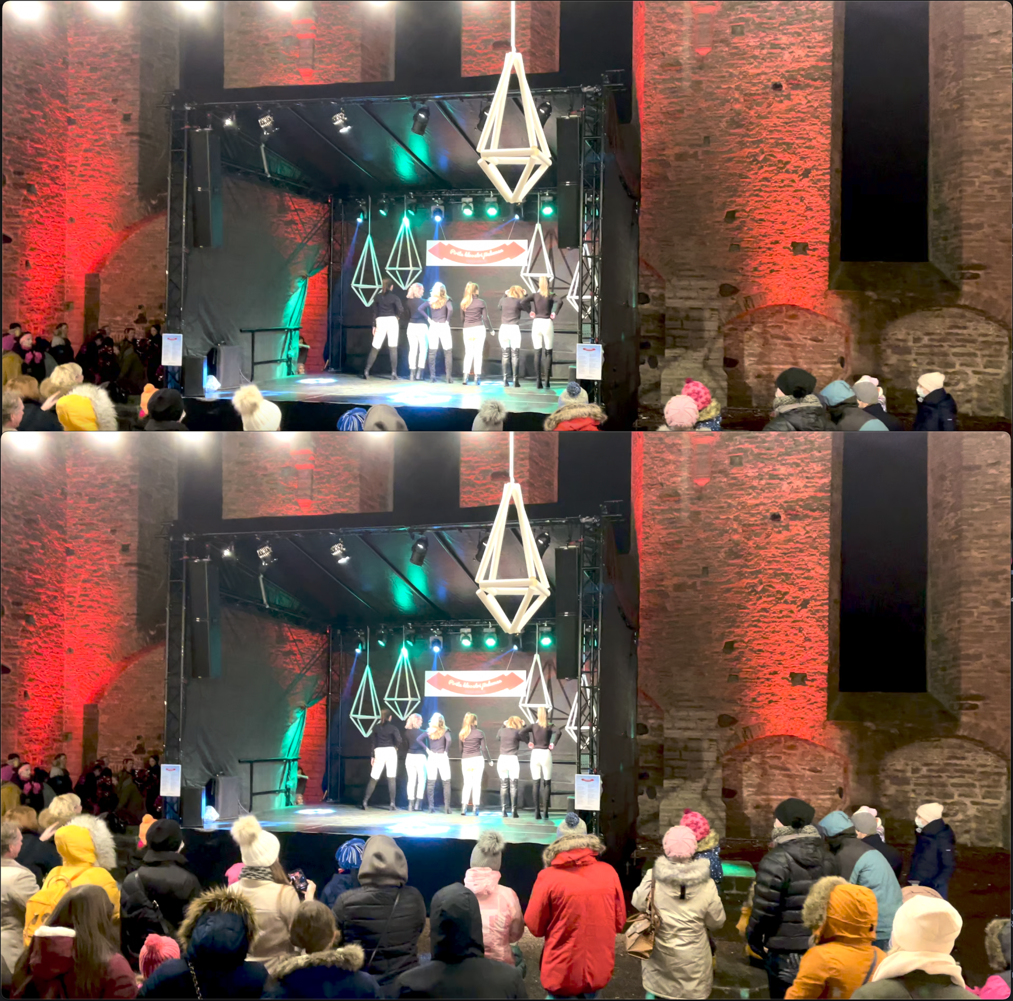

So, finally I came around and tested the iPhone 12 Pro HDR footage as per your suggestion. Copy it from iPhone as a MOV file and dropped into iTunes (nowadays the TV) app.
Just out of curiosity, I also set it through Subler and saved as m4v.
So what did it change? The only thing, I can notice, Subler dropped the Dolby Part from the codec configuration box. The transfer function remains the same (HLG) as OOC (out of camera).
How does it play on latest tvOS?
The OOC file plays back as SDR - so brightness is the usual SDR, highlights are burnt out and colors are not of HDR quality. But it is definitely not flat (akin to the LOG-footage), I was assuming before. It is regular SDR image, obviously taking advantage of HLG's backward compatibility with SDR.
The other file plays back in HDR and is much more watchable, than the OOC version. tvOS seems to convert HLG into PQ, but it looks like a proper HDR - colors and specular highlights pop, just as it should be.

Unfortunately, he does not explain, what is newly introduced (I've never seen it before iPhone 12) Dolby Vision Profile 8, HLG compatible. And how do we eat it.
Some hints can be found here.
And to understand, how HLG is different from HDR10 and Dolby Vision, can be read here.
PS Incidentally, QuickTime on Mac renders both versions (OOC and from Subler) equally.

What I am saying is - if you continue to ingest your home videos into iTunes, as you are doing now, you won't lose the HDR (its still contained in the original MOV file from your phone), but you will have to:
a) wait until tvOS stock player starts to support that particular flavor of Dolby Vision or
b) hope for a 3rd-party player will implement support before tvOS.
Infuse comes to mind instantly. But unfortunately it fails to render OOC DoVi or HLG as HDR - so I get SDR.
Plex client surprisingly recognises DoVi in the OOC clip and engages DoVi mode, but it does not render HLG, so it appears to switch to PQ gamma and ruins the image completely.
The bottom line - you should still archive your home videos as HDR in your iTunes library, but you'd need to wait until tvOS will support them natively.
Plan B - strip the DolbyVision metadata (eg using Subler) and enjoy HDR in plain HLG.
