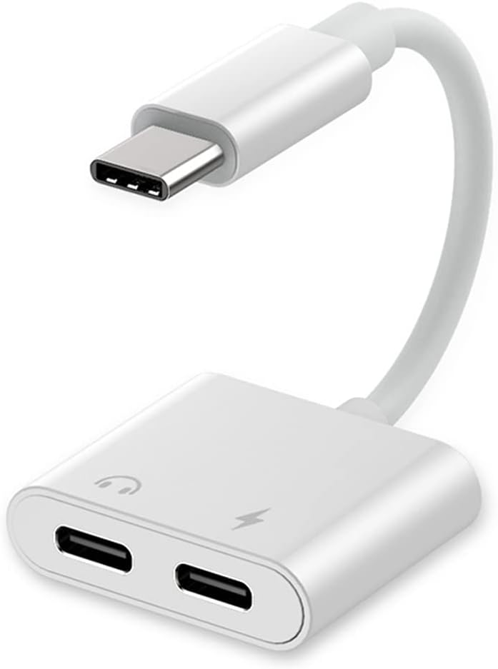

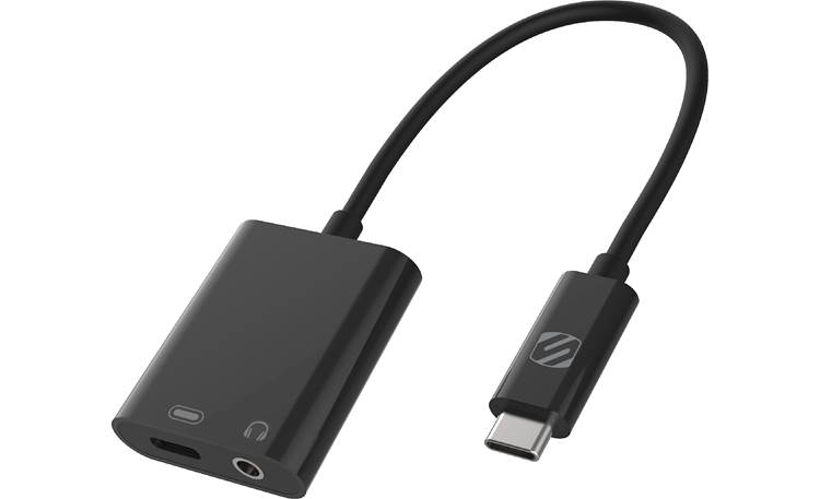

I have been searching for a device that could split the iPhone Pro Max USB C port into two ports but have not found any. Here’s what I believe is needed:
Port 1: USB microphone INPUT: this port would be used to connect an external wireless mic, like a RODE.
Port 2: USB data OUTPUT: sends ProRes video data to an external SSD. I would use this port to connect a Samsung T7 Shield natively powered by the iPhone (<4.8W).
Currently, there are a lot of products offered by the likes of Scosche, Satechi and Belkin that offer:
Port 1: Pass-through 3.5mm audio adapter OUTPUT.
Port 2: USB-C charger INPUT.
More info:
Image below shows a similar device, which offers a charging and an audio port:
Let me know what you think.
More info:

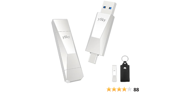

I've been searching for hours and I think I finally found a flash drive that will work with ProRes
The reviews say it works with the iPhone 15 Pro Max ProRes - I'll find out when I get it tomorrow.
Has anyone tried it?
I got the drive yesterday and it works GREAT! At $40 for 256GB - it's worth it to take advantage of the ProRes functionality of the iPhone 15 Pro and Pro Max
