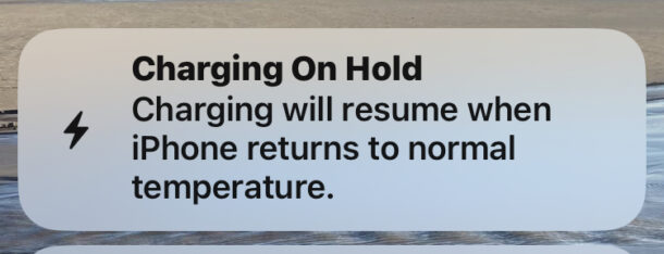

The two times it overheated while I had the MagSafe battery pack attached, a message appeared saying that charging would pause until the phone returned to a normal temperature.
Today it was burning hot, but no message appeared.
That would technically fall within overheating. If it only happens when the battery pack is attached, I wouldn’t be worried. Unfortunately, of course, it’s not ideal. Battery cells are going to heat up when used, whether (rapidly) charging or discharging. I use a power bank with my AVP. I keep both battery packs in a sling bag, and both get toasty, not alarmingly (yet?) but, indeed, also not ideal.
