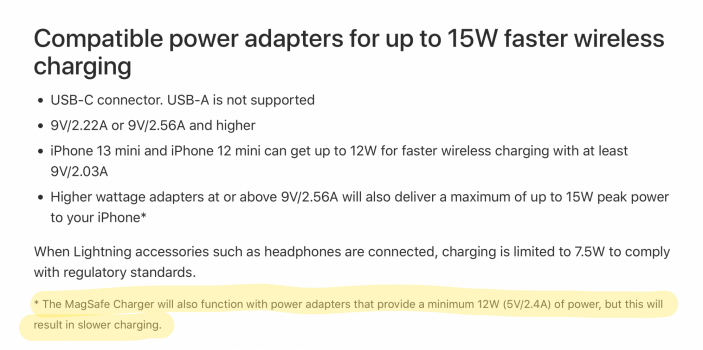

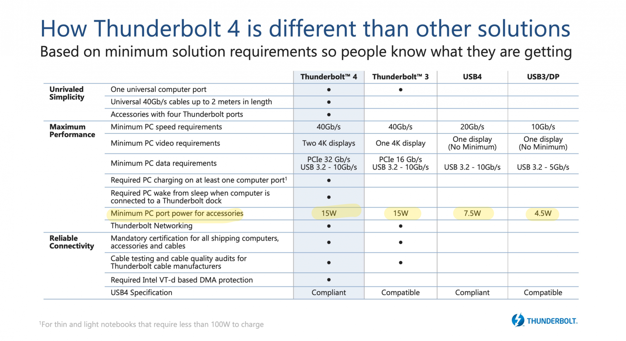

If you're talking about a charger that would be plugged into a computer, I'm pretty sure that won't work and you'll need a wall plug—since the MagSafe fast charging is 15w and requires a 20w adapter minimum. That's not including the Watch requirements, and is higher than any computer port's output of which I'm aware—Thunderbolt 3 or 4 are usually 15w.

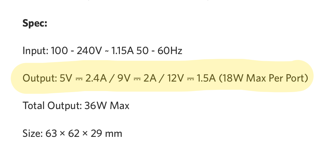

Did not find something adequate and so I bought a power adapter from Anker (Powerport III duo) with 2 PD ports that both deliver 20W. And bought an additional extension cord from adapter to power outlet.

While the Powerport III Duo should work fine with the MagSafe charging puck, it will likely charge at a maximum of about 13w—not the full 15w.
That's because on their spec page for the product, it shows that it outputs 9V-2A (18w)—while to charge at the full 15w, the MagSafe needs an adapter that puts out 9V-2.22A (20w). That's a new spec: 20W Power Delivery 3.0

There's an article about the adapter requirements here:
