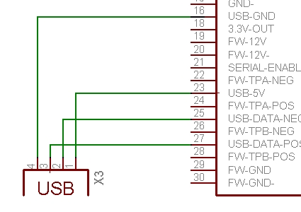

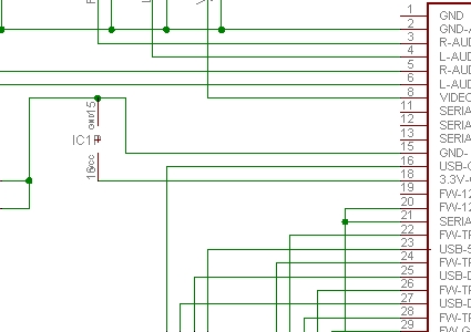

That is a good start, but still only part of it. It is impossible for someone to know (unless they dig into tech specs) if a device with a solid (or built in) dock connector is utilizing USB, Firewire, or just the serial circuitry of the iPod. The issue lies in what pinouts the device is looking at to charge the ipod, and what pins said device is monitoring to tell it if an iPod is docked.
While this link does not go into detail in regards to this exact topic, it does show a breakdown of the pins on the iPod dock connector.
http://www.engadget.com/2006/04/25/how-to-design-your-own-ipod-super-dock-part-2/http://
