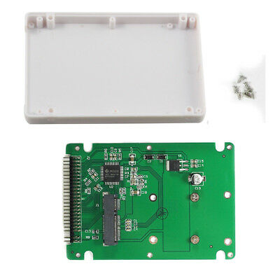

Anyway, I used a $25 Addonics IDE/mSATA adapter. I have noticed more heat, but interestingly enough the Mac rarely breaks the threshold for the fans to kick in.

I've had good success using SSD's in the configuration you're using, the MSATA to IDE adapter route.
I've also had one get unbearably hot, and the adapter was the culprit there. The one adapter I used where that was an issue was Kingston-branded, but I don't know who actually made it. I no longer have it, I threw the thing away, because it became too hot to handle while in use - I mean, it would quite literally burn you. The SSD however, when placed in a different adapter, did not cause such problems.
You'll find differing opinions on adapters around here, with some swearing by a certain kind with a red PCB similar to what @eyoungren just linked; I haven't tried those because I've found cheaper options that work fine. This is similar to the adapters I've used [note to mods: not my auction]:

I had actually purchased one of these cheap adapters (I still have it) the first time I tried to install a SSD. I went with a name brand (I want to say Samsung, but I don't recall correctly). Got it all installed and the Mac never saw the drive.
Whether that was due to the SSD itself or the $8 I paid for the adapter, I can't really say. So, then next time I went with @AphoticD's suggestion regarding the Addonics. Zero problems.

Yeah, had it been an iBook I was working on, I would have waited until I got the Addonics the first time. To go through all that only to find that the system does not see the SSD would just make you want to cry - or hurl the Mac against a wall, both bad situations.

In any case, I feel the Addonics is worth the price. That's just me though, as you've already said, everyone has their own thoughts on the matter.

Other folks have suggested mSATA-to-IDE adapters. Yeah, they work fine.
There are also m.2-to-IDE adapters which I’ve also used (I’ve used twice as many of these in all). At least locally (since the start of 2019), it is easier and cheaper to acquire m.2-form factor SSDs over mSATA SSDs. The IDE adapters are generally about the same price between the two SSD form factors.
