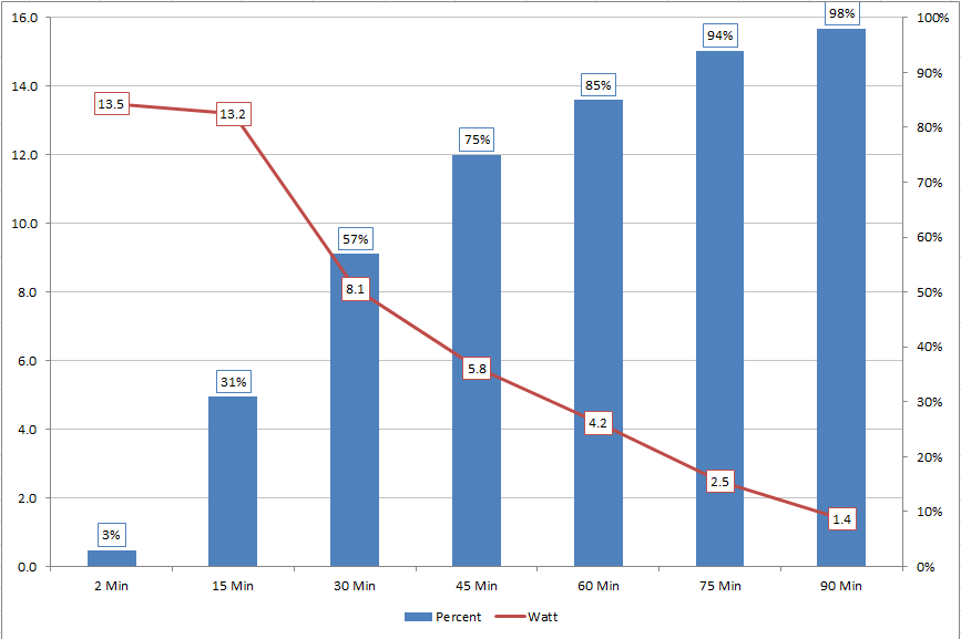

Efficiency of both bricks is likely to be around 90%+ as far as I can tell (I only have Apple 12W and 30W). As mentioned, primary difference would just be charging speed. Total power consumption (kWh) will be around the same. 18W would just use higher watts and finish charging more quickly while 12W would use lower watts but take a longer time to charge.

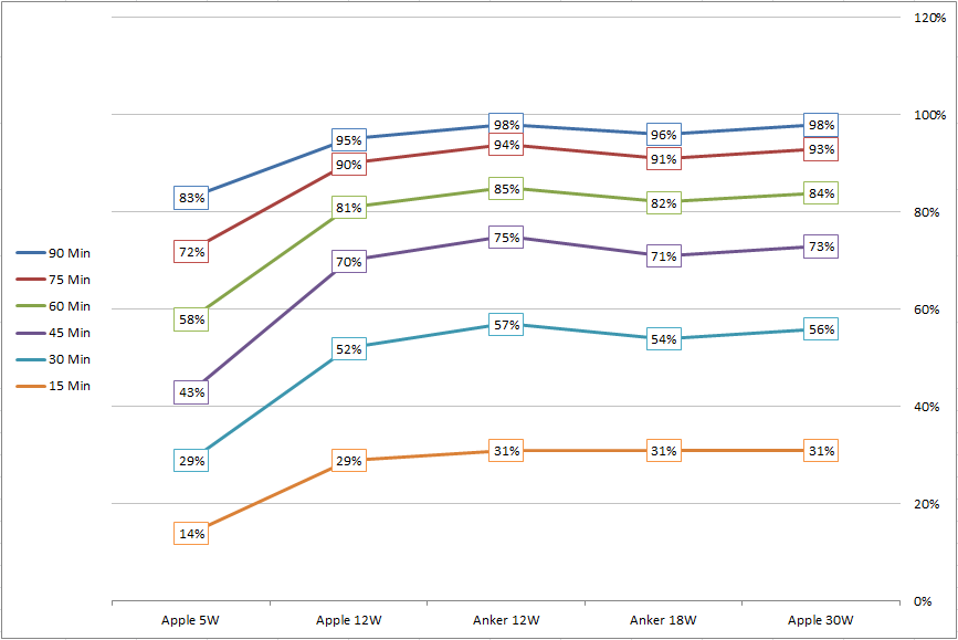

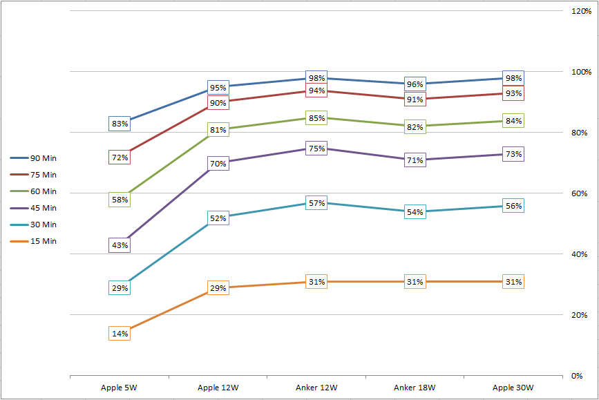

The phone decides how much power to draw in order to reduce unnecessary battery wear. Below is iPhone SE2 charging.
Complete set of tests. I think the differences between 12W and 18W charging just falls within the margin of error here.

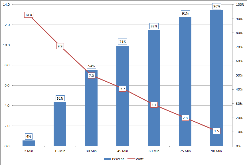

I remembered to use the Kill-A-Watt for the Anker PowerPort PD2 (last two tests) so I have power draw measurements from the wall for Anker 12W and 18W. I find it interesting that the USB PD protocol dropped off more quickly compared to the Apple 2.4A.
Anker 12W
USB-A to Lightning
Anker 18W
USB-C to Lightning
Here are graphs for iPhone X. The 11 Pro would be similar to this.
