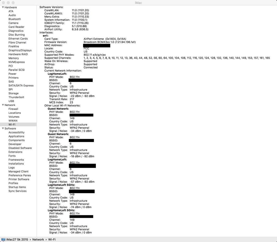

When I check it under About this Mac > System report it shows this under the wifi portion:
Supported physical modes it shows 802.11ac, but the networks it shows being broadcast are "just" 802.11n, so I'm confused.

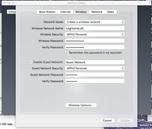

How do I get the 6th Gen Airport Extreme to broadcast in 802.11ac mode?
Did you go into the "Wireless Options" and turn on the AC with a slightly different name then the N network SSID?
Yes, it's got the "5GHz" appended to the end of it ......
I'd like to see others About this Mac > system report > wifi and see if theirs shows 802.11ac network .
What does yours show?
This looks like Apple's older 5G flat router setup!
Well I'm running latest Mac OSX on that late 2015 iMac 27", the screen shot is from the Airport utility application, that Apple Airport Extreme was bought Oct-2014.
So I'd like to see others that have confirmed 802.11ac from it .....

That is definitely the new 802.11ac model AE and your iMac supports AC, so something else is going on.
It looks like you are connected to the 2.4GHz band though. Try clicking the wifi radar in the menu bar and join the 5GHz band then option key click the menu radar thingy and see what it says.
I do notice something odd though. In that System Report screenshot, it shows all the networks (guest, 2.4, and 5) each two times. Look at the bottom and the 5GHz network is there twice on channel 149, but they each have very different signal levels. Do you have another router setup with these same SSID names?
I was wondering about the same thing...
Why do you have 2 full sets of wifi signals?
You must have a second wireless router. The signal quality is significantly different, so you should try turning off your OTHER wifi router - the one which is further away - then try your wifi (from your Mac, turn the wifi card off then back on)
You can't really force the router to connect at AC speeds. That connection is set when your wifi card negotiates the connection from the router.
I do know that the wifi router that I have (a TP-Link brand) will NOT use AC if the guest network is enabled. It's some kind of tech issue with how that router works with guest access.
SO, test your router after turning the guest network OFF, just to see if that allows the AC connection.

Ok - my iMac 2015 is 4 feet from the extreme, so I did this without going into the basement (it's 2am)
"LogHomeLoft" network is 802.11 n
"LogHomeLoft 5GHz" network is 802.11 ac
Clear I agree the 5GHz is showing 802.11 ac, so that beckons why did the About this Mac > system report > wifi show wrongly?
That's what led me on this wild goose chase in the first place.....
(ok, so there's a bug in that part of Mac OSX 10.11.3 (15D21) I guess is the answer)

What puzzles me is the system report seems not to sense the ac network, I don't see it in the other network wifi portion, only the connected one .... so what's up with that?
I have no idea why it is showing that way. At least we know it really is connecting over ac though.
