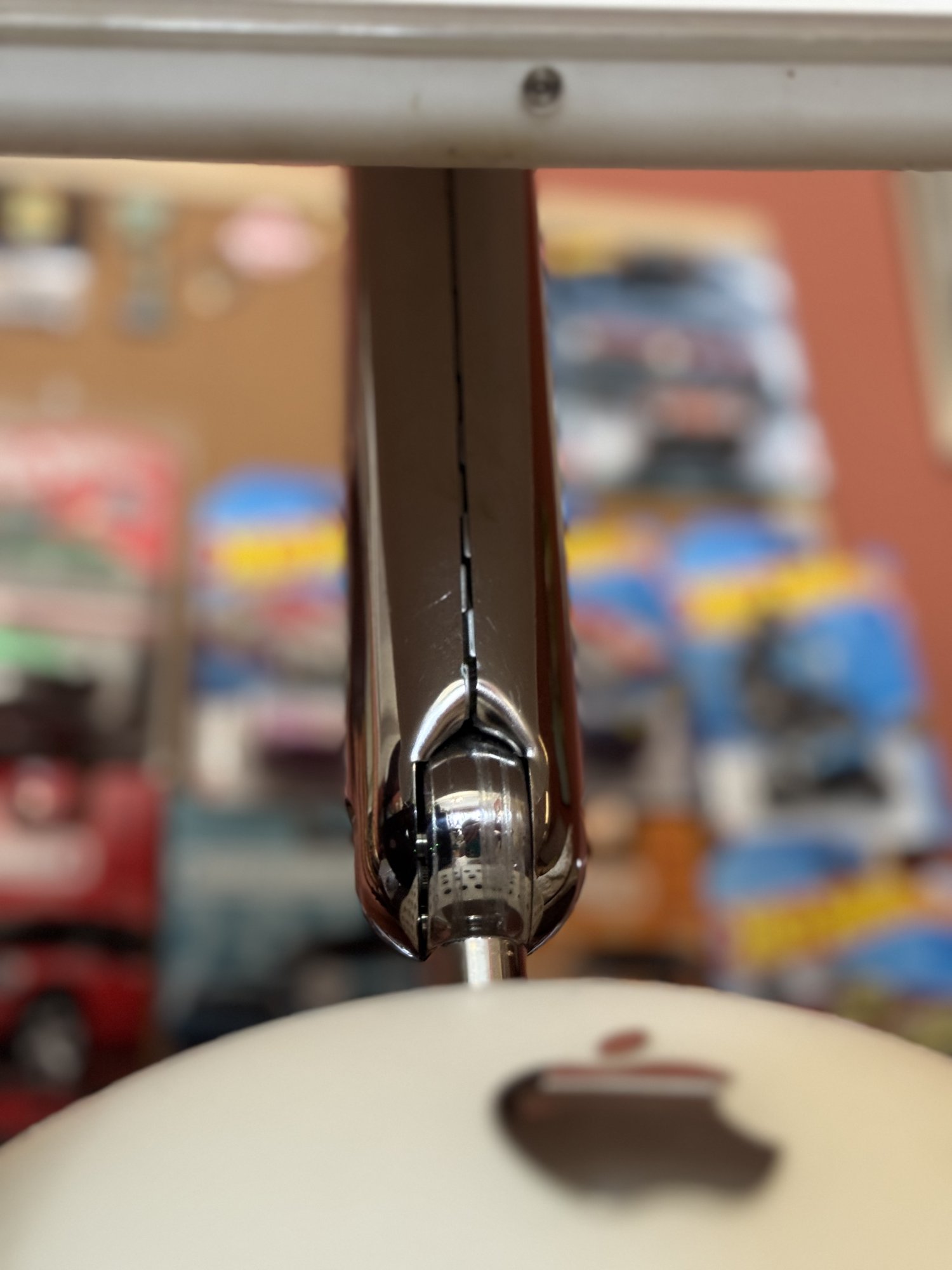

I bought an iMac G4 on ebay. The box had a big hole in it (thanks USPS), and the arm has seemed to have slightly come apart during shipping. Getting to the point, I'm wondering if the computer is supposed to be making this noise when it's on.

The arm isn't loose; it's actually a bit harder to position. It makes a crunching noise when moved vertically.
