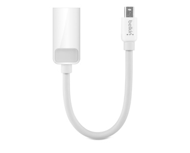

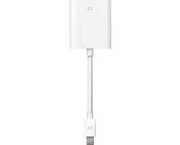

Mini Display port to VGA adapter and Mini Display port to HDMI adapter
Both available on the apple online store

I already have a VGA and HDMI connector, the trouble is getting them to work with only 1 port.
