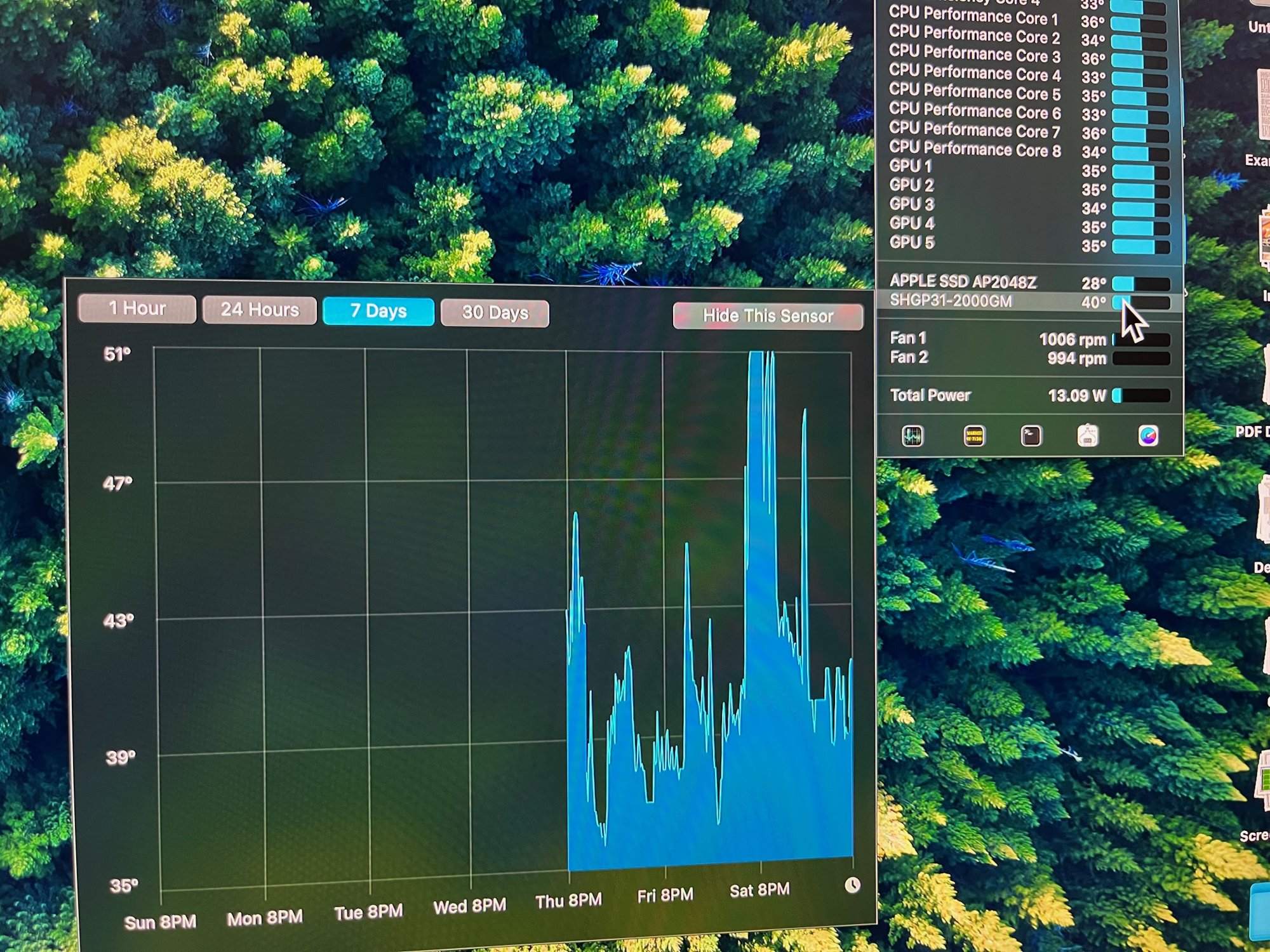

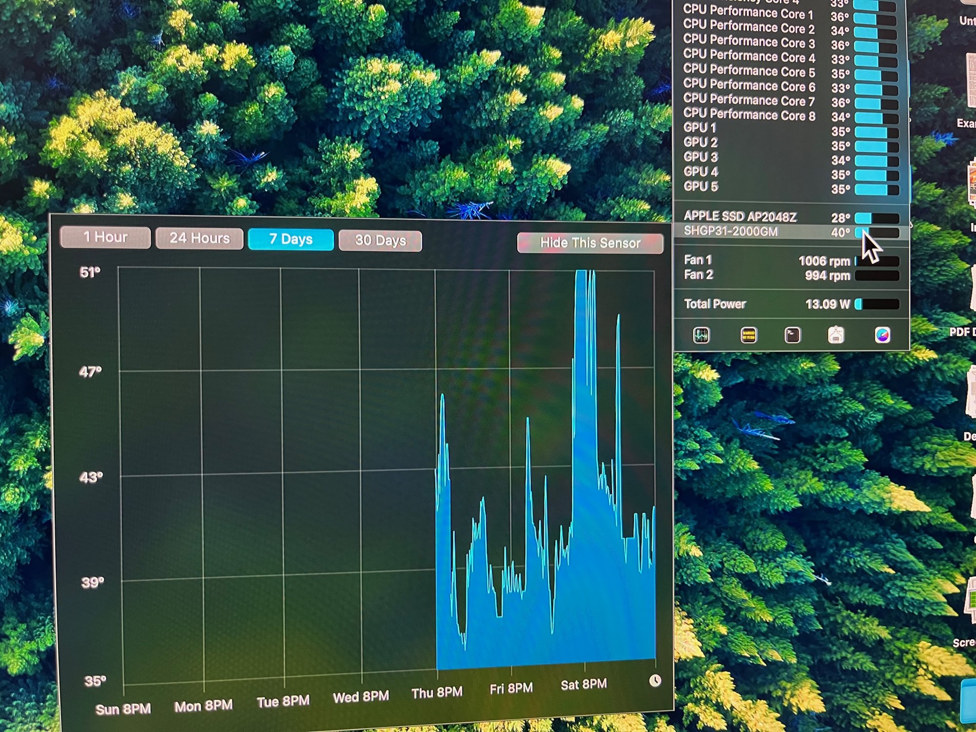

I have by TBU405 (housing a 2TB SkHynix P31) resting atop my Studio, and it does not feel warm, at all.
Here's a 7d iStat graph (I've only had it four days):
Seems to hover at around 40C
50C spike was when I forgot to set it atop the Studio.
I have not performed extensive disk operations with it, yet.
