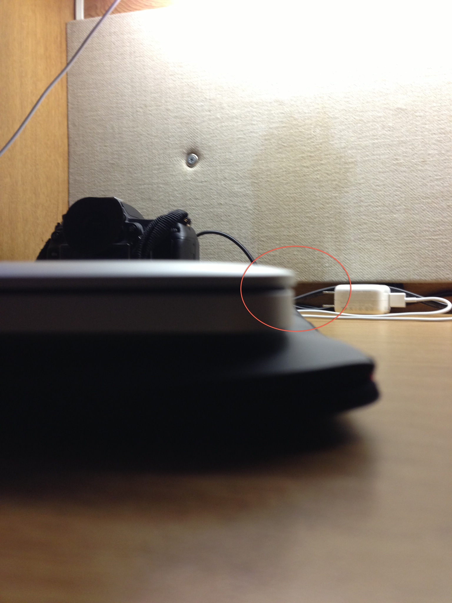

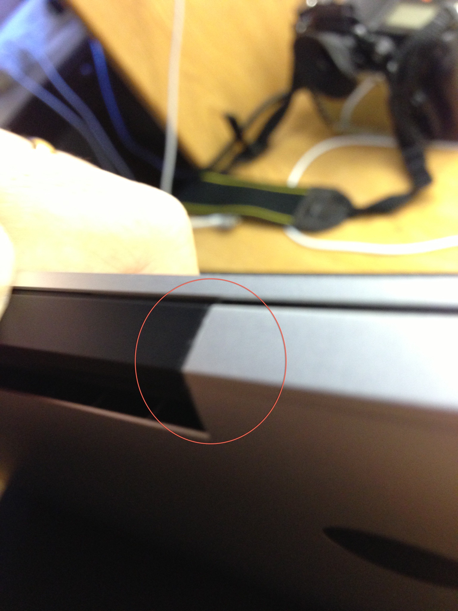

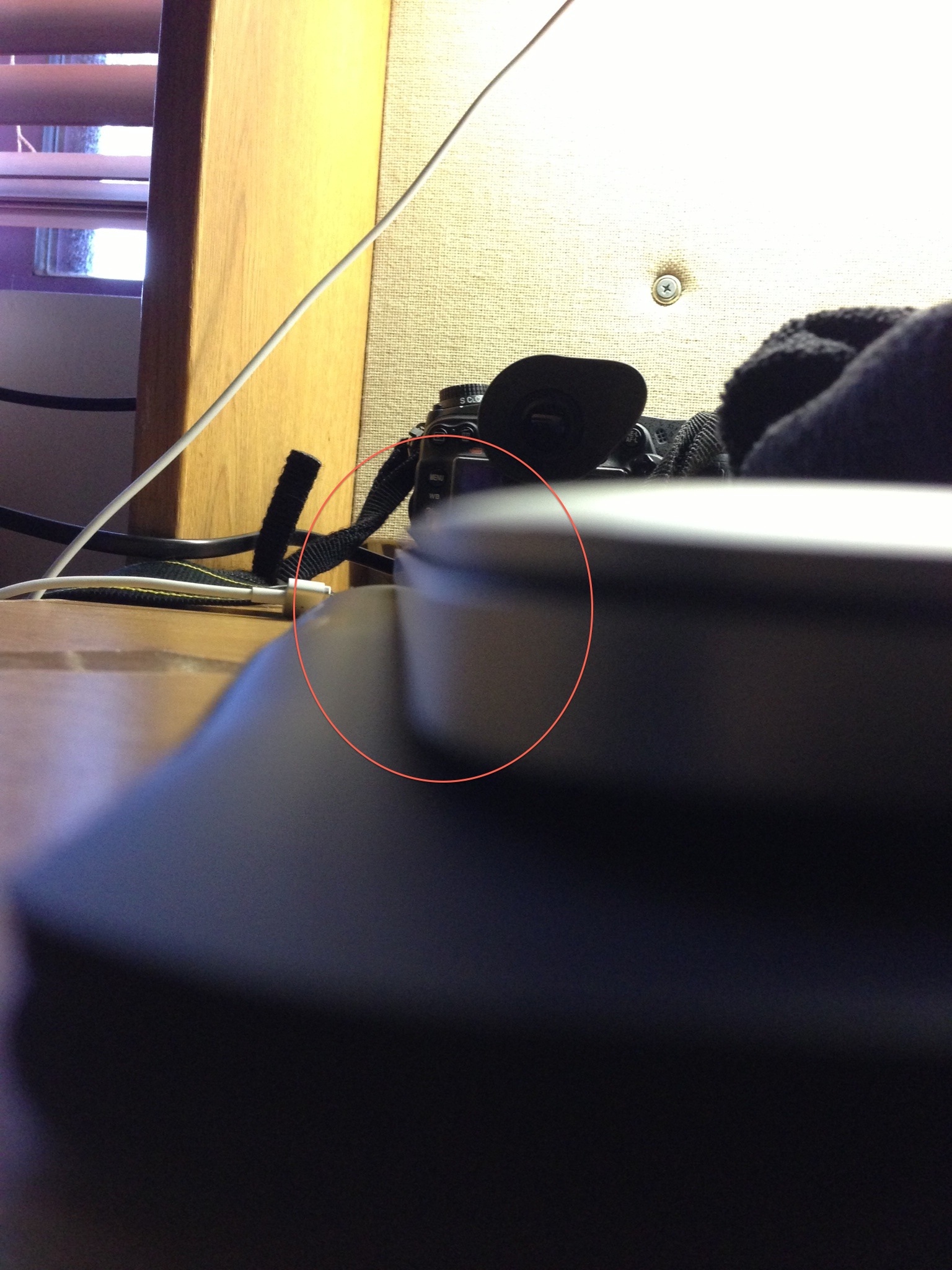

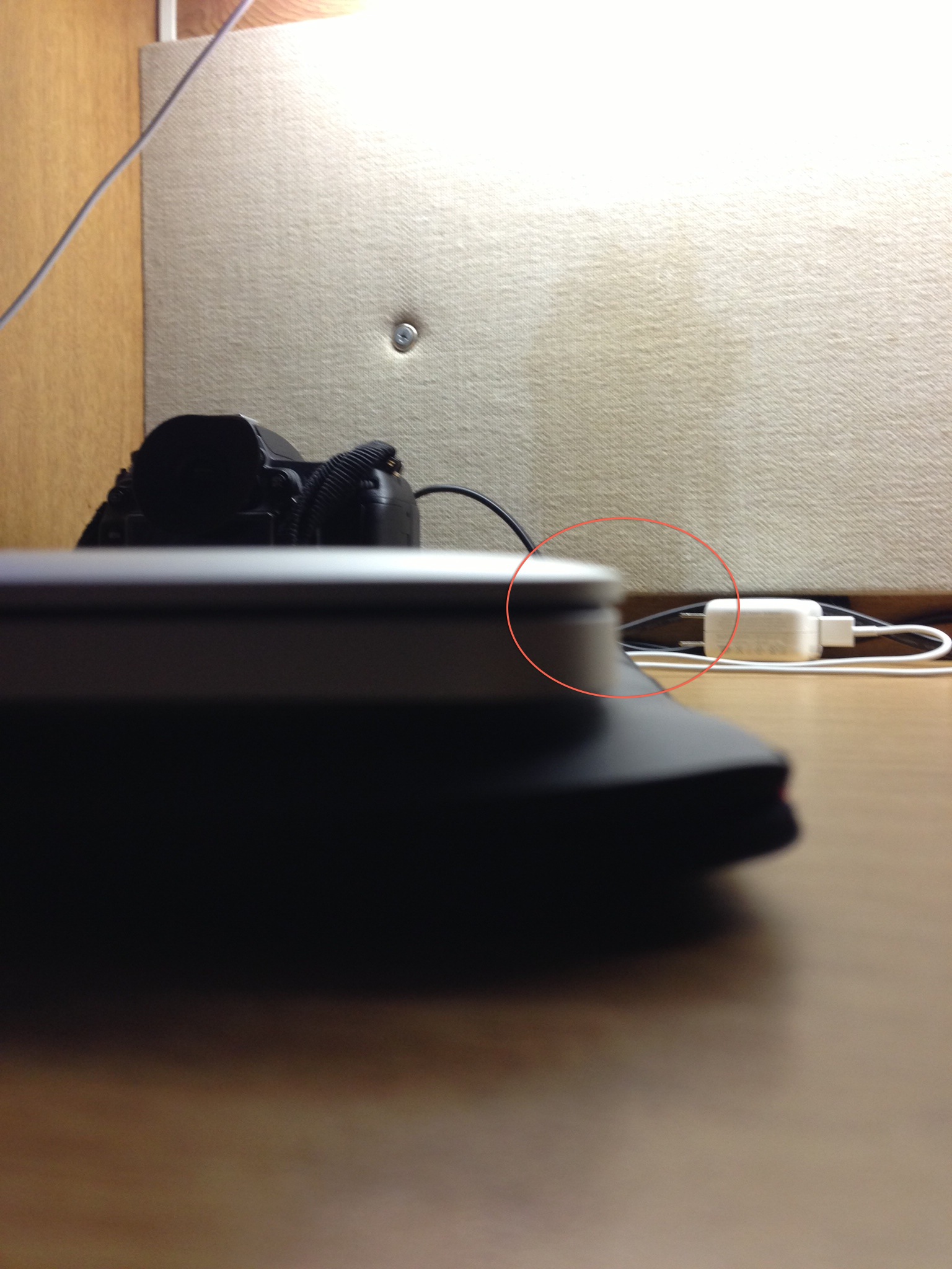

I dropped my rmbp just now, but only minor scratch. However after i look through, my display is not equal. As you can see in the pic, the display lid is not equal when i close the lid. On the left side the lid is going inside and the body of the macbook is coming out , on the right side the lid is coming out and the body is inside. At the back , where the black thing is located, one side is coming out and one side is coming in. Is it normal? do you guys also have that?

I've got the 13 inch macbook retina and this isn't normal but, I found this weird as on my last macbook 13 inch white, I dropped it and it's done exactly the same thing. The lip of the screen comes out over the body. I've had it like this for several years and it wasn't really a problem.
It's adjustable. You need to take the bottom off, loosen the screws on the display hinge slightly, adjust it so it's level and then tighten them again.
Your local Apple store should be able to do it for you too :).

As mentioned before, this is an extremely easy fix given that you have pentalobe screwdrivers to open the bottom cover and a torx screwdriver to realign the display assembly.
I had to reseat mine when a genius failed to align it properly after getting a top case replacement.
Once you get the bottom cover off, find two triangular rubber pieces near the hinges; one on each side. Remove the rubber piece to reveal the 3 torx screws that aligns the display with the case. Remove 2 side screws but not the centre screw so that you have enough degree of freedom to adjust. This helps to align the display without having to realign the whole assembly later.

they said i have to give them the computer for a week to fix this
That's normal. If they approved the repair, you can always drop it off at a time when you can part with the machine for a week.
