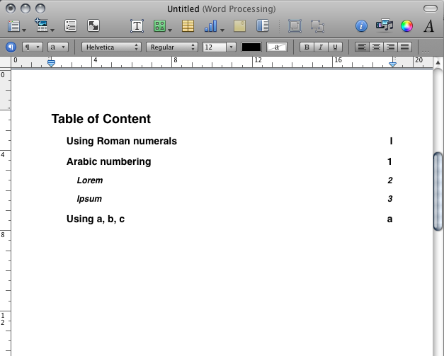

I know this thread is old, and that the original poster has handed in the thesis a while ago (I'm assuming)... but I thought it was a good idea to just let everybody that finds this post via searches that Pages '09 actually has a working TOC.
I just did a quick try, and I used both Roman numerals, Arabic numerals as well as a, b, c numbering. It worked perfectly, showed up in the TOC without any editing etc, so the "feature" has been fixed in the latest version of Pages.

Like I said, I just tried it out and it works just like the thread starter was asking for. I'll attach an image of a very simple TOC that uses different numbering techniques.
So you are saying that the work-around referenced in post #10 is no longer necessary?
Exactly. What I did was to divide the documents in different sections (section break), uncheck the "use previous headers & footers" box under Section, and added a Page number to the footer. Right-click on the page number to select style and select "Start at:" under Section to have it always start at the first number no matter what style (i.e. a, i, 1). Then insert a TOC and it uses the correct numbering styles that you see in the footer.
So nothing weird at all, everything that is already described in this thread, only difference is that it works out of the box now with Pages '09. So if you save it as a pdf-document the page numbers in the TOC will be linked to their page, even when they use Roman numerals or a, b, c.
