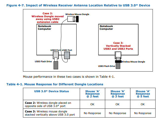

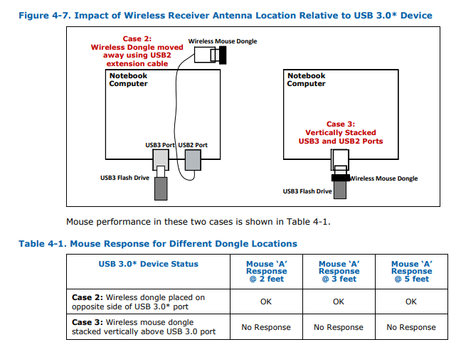

Ever since 2012 with USB 3.0, I have been having this problem and i thought it was always there and used an usb extension cable to put the mx dongle as close as possible to the mouse and been using wired keyboard with no problem. Apple trackpad is glitchy so i stopped using it.
For the wireless keyboard and mouse stuttering, it's not an early adopter problem, it's a tech design flaw right from the start that just appears to affect smaller machines more problem cos they can't shield it as well. Even my NUC has this problem. I think bluetooth is 2.45ghz.

For my case on a mini, i extend the usb dongle a distance away from the mini and its been working well from 2012 till now, mx, mx2, mx2s.
For macbook air, it would look silly to extend a dongle or use a wired mouse indeed.

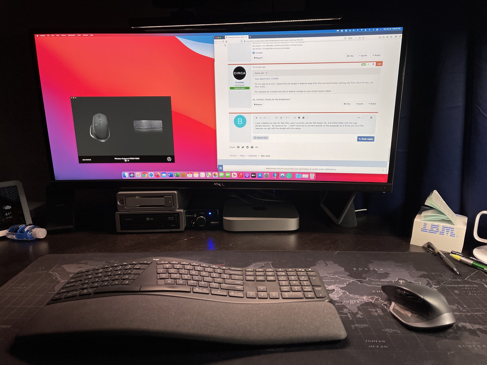

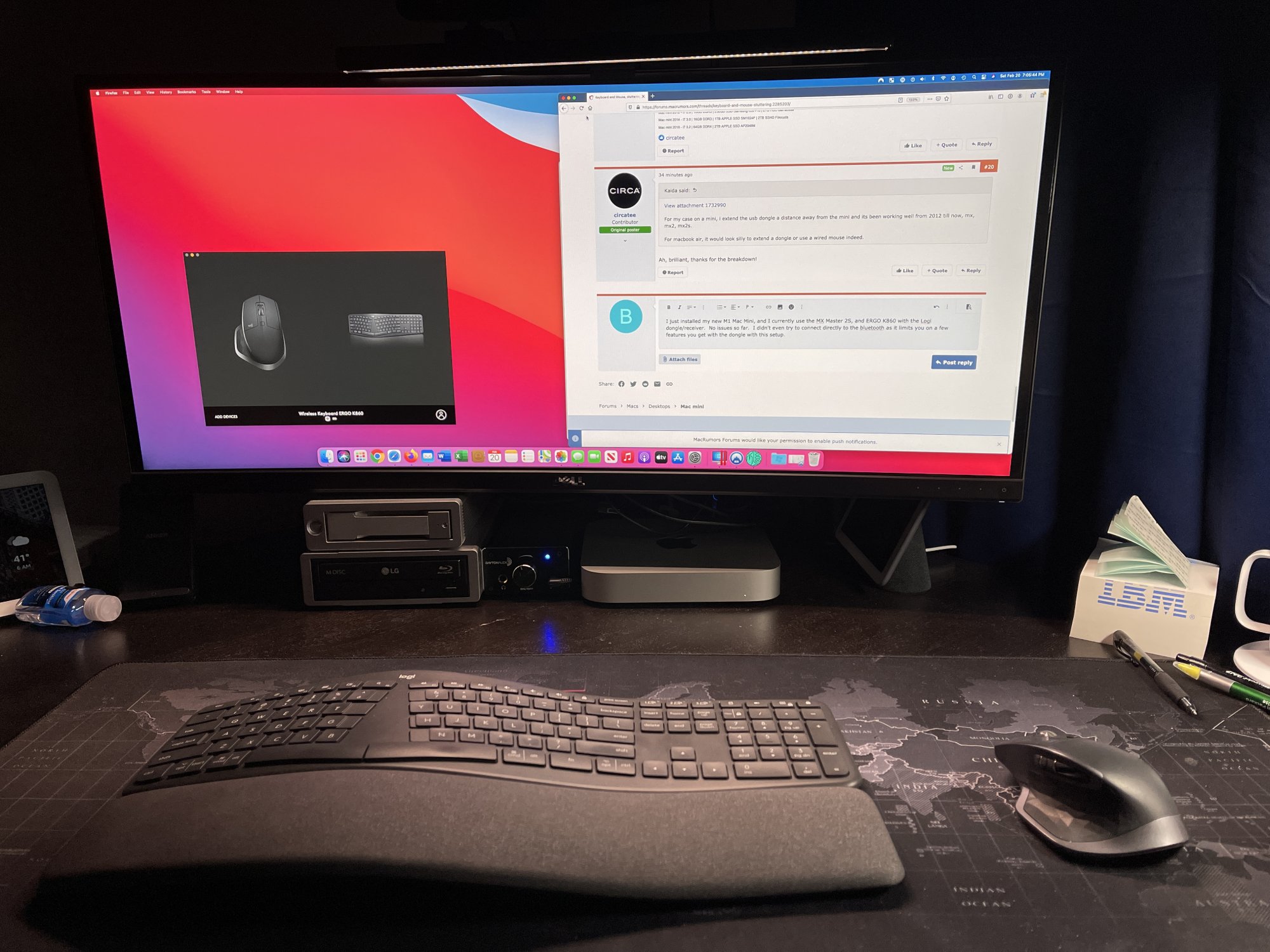

I just installed my new M1 Mac Mini, and I currently use the MX Master 2S, and ERGO K860 with the Logi dongle/receiver. No issues so far. I didn't even try to connect directly to the bluetooth as it limits you on a few features you get with the dongle with this setup.
Reactions: circatee
Lovely setup! As a matter of fact, I am now connected with my Logitech Keys keyboard and MX Master, via the dongle (borrowed it from my Windows PC). And, NO stuttering or anything!
