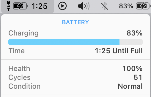

I was thinking this could possibly be related to battery health, but as the following iStat menus screenshot shows, the battery health is 100% with only 51 charge cycles.
