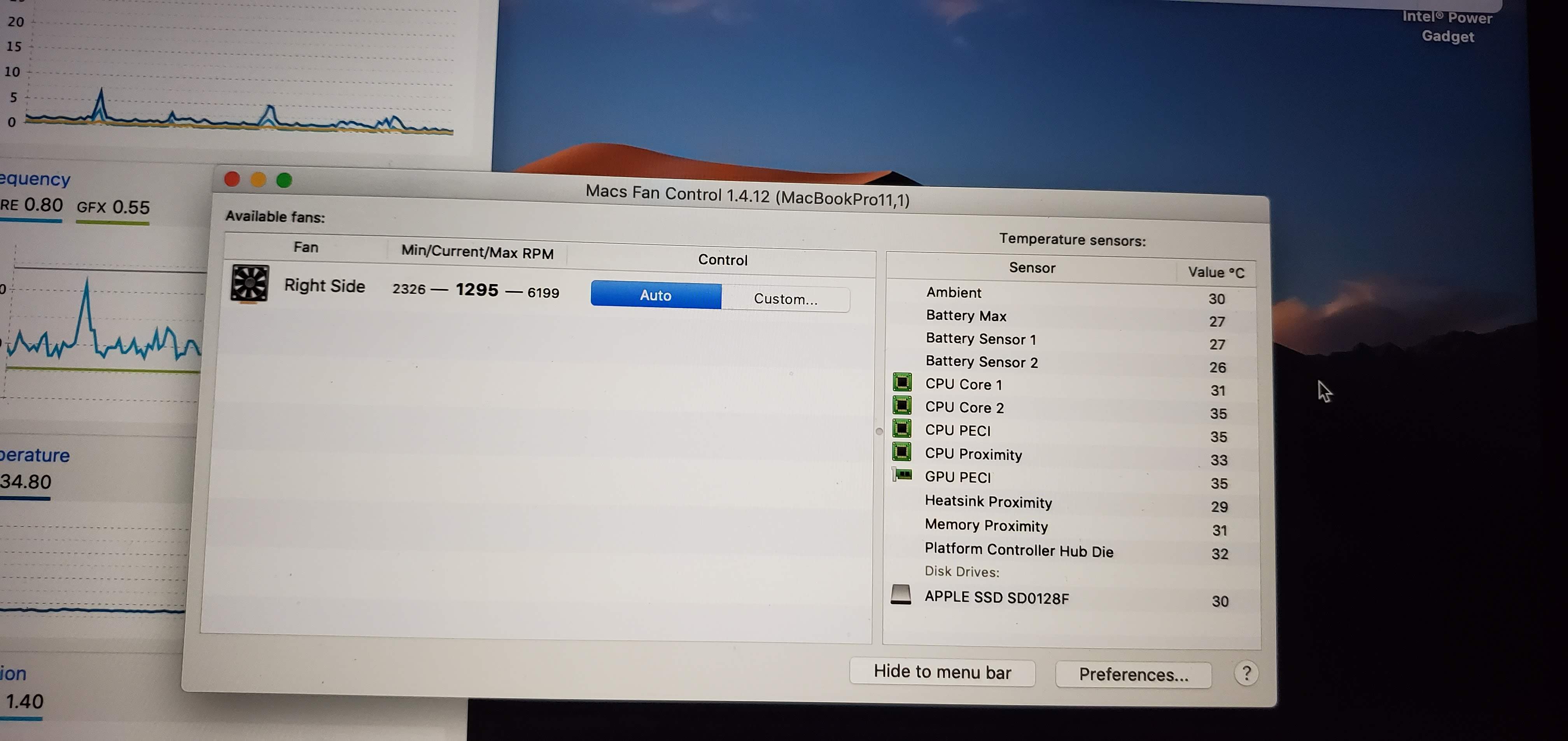

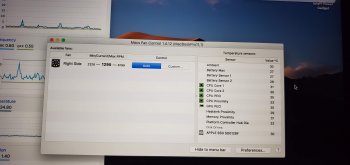

Attached is a screenshot (photo of the screen, haha) of Macs Fan Control, when kernel_task is currently cooperating and acting normal. Strangely? At the time of the screenshot, the computer was plugged in with only a few applications running in the background. Here are the temperatures. Pretty decent.

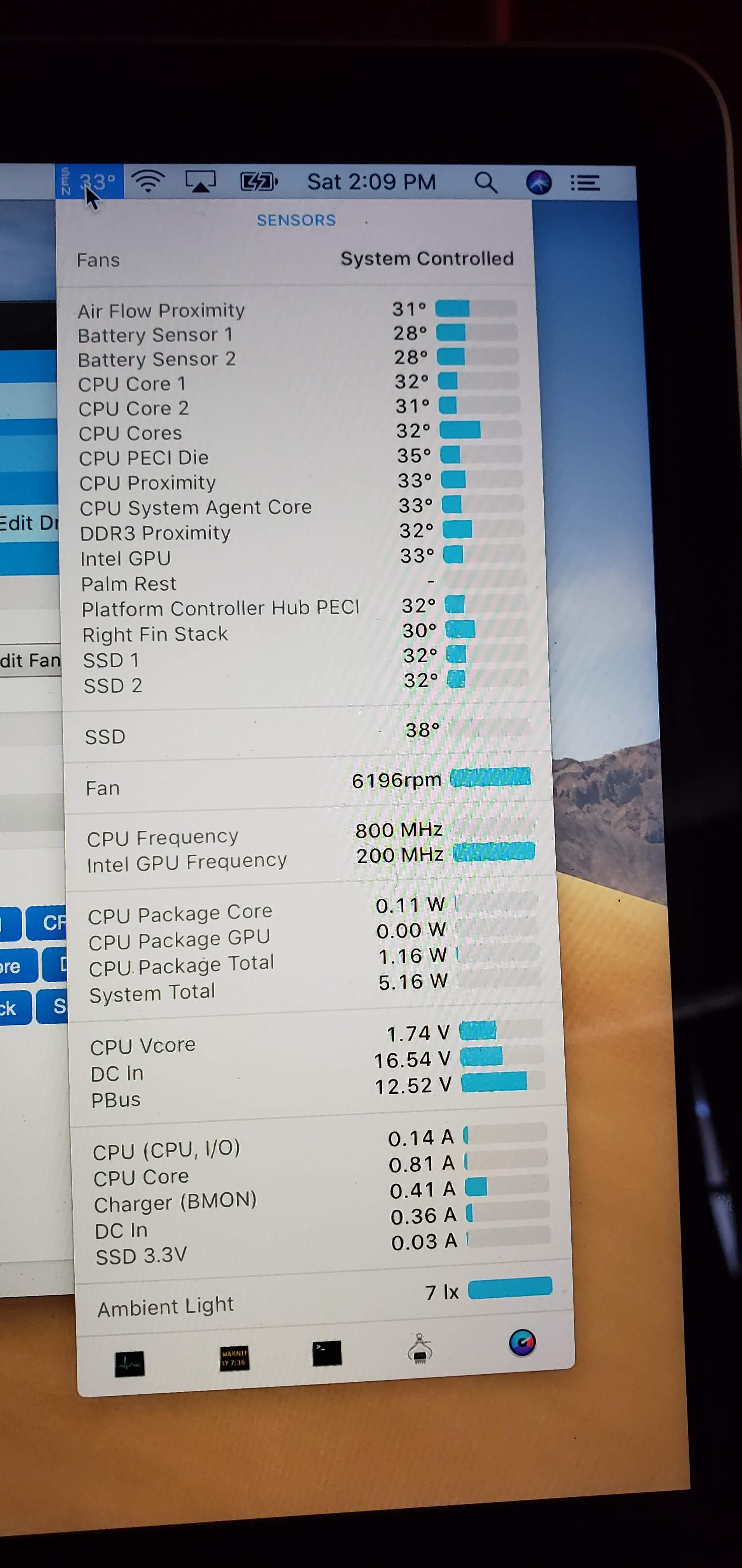

I cleaned the die and the heatsink very thoroughly with isopropyl alcohol. I applied Arctic Silver 5 thermal compound using the "line" technique, carefully ensuring not to apply too much or too little. I also did the cross-torquing method, as you said. Temperatures are as follows in the attached image. Thank you for your assistance so far! :)

Yea that fan speed is way too high for the temps you're getting. I noticed the palmrest sensor isn't reading. Unless that model doesn't have a palmrest temp sensor, that would cause the fan speed issues. Macs go into a failsafe mode if a sensor (even a seemingly unimportant one such as a palmrest sensor) doesn't read. if that sensor is the cause, a battery replacement (that replaces the entire topcase) might fix your issue. You might want to take it to an apple store and see what they say. The other sensors look normal.
[doublepost=1560633978][/doublepost]It *could* also be the trackpad cable that connects it to the logic board. The Genius Bar has more through diagnostics they can run. It shouldn't be maxing out the fans under such cool temps unless a sensor is faulty. From the looks of it, the palm rest sensor is faulty.
Reactions: three
