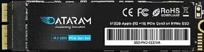

I see some Dataram SSD’s that claim to be compatible with the 2015 iMac 16,2 EMC 2889. Anyone know for sure if these work/fit? Why are these iMac 16,2’s left out of compatibility?

I just installed an M.2 NVMe SSD in the blade slot of a 2017 iMac 21.5 inch. There are a number of adapters you can find on Amazon that will make it possible to use any standard 2280 M.2 NVMe drive in the apple blade drive slot. I then upgraded the OS to Ventura using OpenCore Legacy Patcher. And it all works great. Getting to the back of the motherboard of the iMac may be a little more than the average DIY-er wants to deal with, and it's certainly not small task - removing virtually every part inside the case. But in your case where you have already removed the motherboard, it's as simple as getting a $10 adapter from Amazon.
For those who want to avoid the work/time/risk involved in this challenging upgrade, I recommend taking advantage of the Thunderbolt 2 ports on this model and get an m.2 NVMe SSD from Amazon (cheap these days) along with a thunderbolt 2 adapter/enclosure. Then you can install MacOS on this external drive and still have all of the speedy benefits of the NVMe drive connecting at the speed of PCIe. Much simpler. Just as fast. It just won't look quite as clean as the internal option.
You only have a PCi-e slot if the logicboard you orderd was orginially configured with a fusion drive. If the standard option of the 1TB HDD was chosen you do not have a slot for a blade drive.
