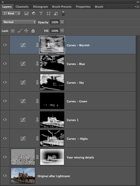

Interesting... thanks. Can you share what the settings/curve looks like for the building/wall?
EDIT: Would it be possible to get anything close to this result using just one curve tool as a global adjustment?
BTW, I need to tone down my sky... LOL... it looks a bit neon! :( (Done!)
1. Can you share what the settings/curve looks like for the building/wall?
2. EDIT: Would it be possible to get anything close to this result using just one curve tool as a global adjustment?
3. BTW, I need to tone down my sky... LOL... it looks a bit neon! :( (Done!)
1. Nope. I've since deleted the TIFF. Sorry.
2. Nope.
3. You sure do. What were you thinking? :p
