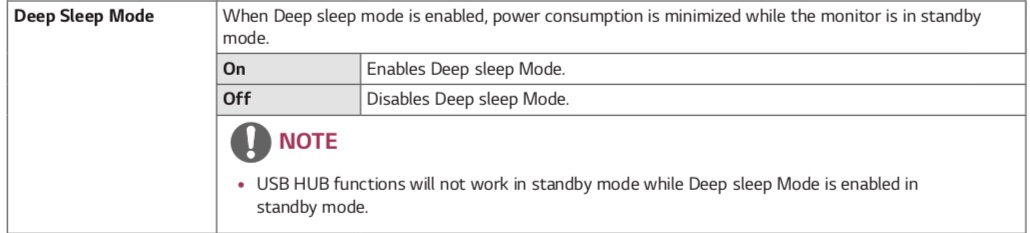

It’s called Deep Sleep mode on my LG monitor, turn it off to keep the USB active.
Hey thanks. However I just noticed it is already off on mine, Automatic Standby is also off and Smart Energy Saving set to low.
The only power management setting I have activated is on the Mac side to turn off the screen after a set amount of time. I even keep the computer from taking naps with caffeinate -i most of the time.
