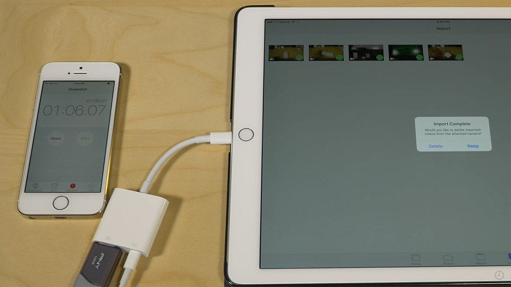

Did brief test on 12.9 iPad using a standard USB flash drive:
1: Requires external power
2: Once external power is added iOS automatically opens import function in Photos
However it appears you move files to the flash drive but not the other way using photos.​
3: VLC does not see Flash Drive (I have not investigated VLC fully)
4: The iOS video app did not see flash drive, or at least I do not see an option to view files from flash drive
Do you have a particular app you are interested in moving video to?

I hooked up a USB 3.0 cable from a 12W adapter/LUSB3CA (lightnight to usb 3 camera adapter). At first it recognized a thumb drive I plugged into the hub and opened photos. No go on the ethernet, however. Tried unplugging it and plugging it back in, and the power light on the adapter would blink on very quickly before going off for 3x time, blink again, etc. So I'm guessing it was a power issue.
This ethernet adapter plugged directly into the LUSB3CA worked flawlessly:
http://www.insigniaproducts.com/products/computer-speakers-accessories/NS-PU98635.html
[doublepost=1462208747][/doublepost]UPDATE: just tried the Aukey ethernet hub/adapter again. It worked—for two websites, and then my ipad restarted itself. LOL.
I tried a USB flash drive as well as connected it to a power source by lightning cable, I can see the Import folder on my Photos app for few seconds then disappeared, My device is iPad Pro 12.9 second generation, Did i do something wrong? I watched several videos about connected USB sticks via this method on Youtube and all were success.
