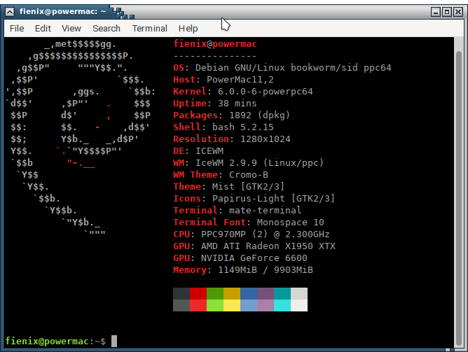

I have a spare GeForce 6600LE. If I put that in the 8x slot and hooked one of my two monitors to it, do you think it would work? Or would it just try to use the Radeon in the 16x slot?
Just as a follow up, here is my neofetch output showing both cards.
You'll notice the x1900's fan will stay running if you boot in to Linux. To cure this, boot in to tiger or leopard first, then reboot in to Linux and the fan will stay silent.
