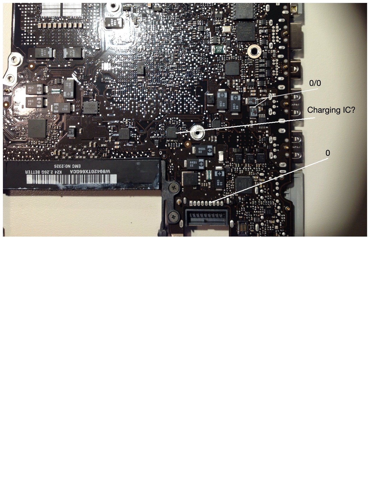

Hello,
I'm looking for conformation that the two fets? Are part of the charging circuit for the battery? While plugged in to ac and with the battery connected I am getting 0 DC wattage from the fets. The battery connector 4th from the right in the picture is reading 0 watts. The MBP works, all except for charging or seeing the battery. At first there was no battery seen. After a ultrasonic bath for the logic board with Elma tech a1, it recognized the battery but it's not charging or running off the battery. Only the ac. So my next plan was to reflow the charging IC the solder looked a little rough, not so shiny. And or replace the two fets not showing any power. I would like to see if anyone would approach this different way?
