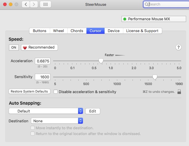

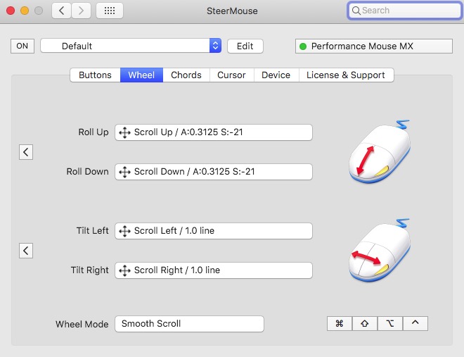

If you dont mind, can you post your steermouse settings?
Especially the ones for Wheel and Cursor.
"If you dont mind, can you post your steermouse settings?
Especially the ones for Wheel and Cursor."
These may or may not be helpful:
