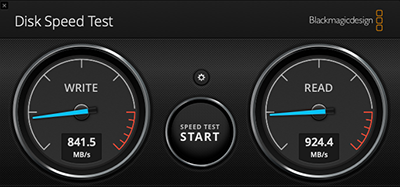

This is the performance I get from the 2tb T7's on the 2018 Mini with USB-C.

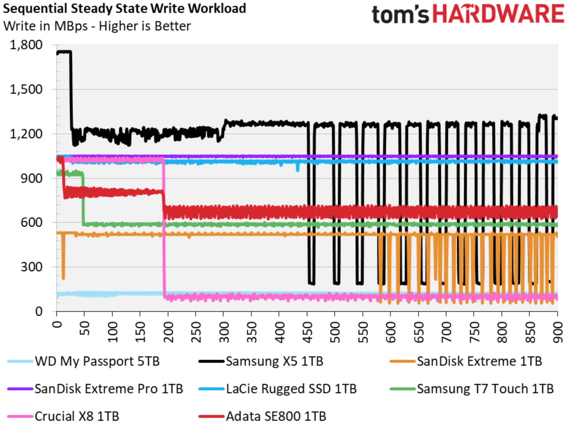

We've been buying the ADATA SE800 as of late. It's cheap, fast, small, durable, and reliable and it uses a good chipset, a good controller, and good NAND. It's a solid drive for what it is, and it has reasonably good performance even in sustained workloads. However, like most modern SSDs, it uses a cache and it does suffer from degraded performance after that cache is exhausted during extremely large writes.
That said, as you mentioned you care about sustained performance, the Sandisk Extreme Pro is probably your best bet if we are talking specifically about available 10 Gbps externals (and further, IIRC it has good thermal performance in these sustained situations.)
(Finally, if sustained performance is of absolute critical importance and you are constantly going to be writing massive files, the Samsung 970 Pro or WD Black NVMe slaughter most everything else if you are writing files large enough, although this has more applicability if you are interested in eventually moving to a TB3 enclosure down the line and making full uses of these would necessitate an enclosure that excels at heat dissipation.)

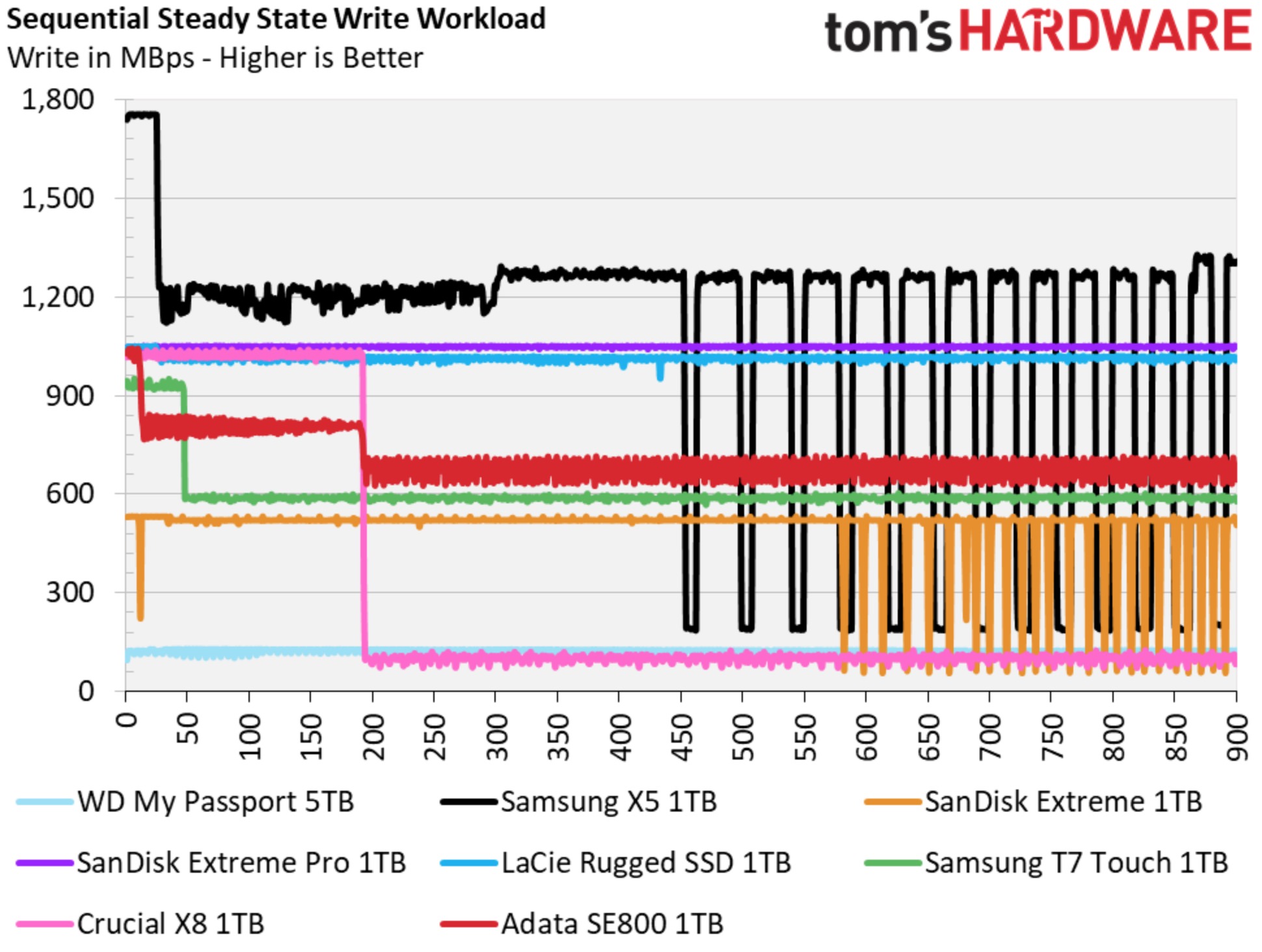

Thanks for the diagram. The SanDisk seems like the best bet. It actually has a WD Black in it BTW.
