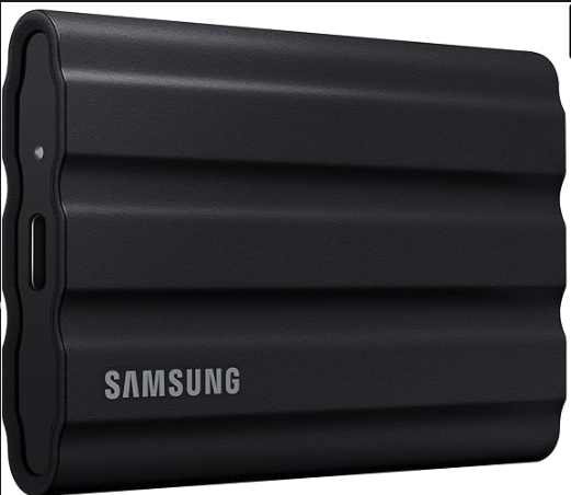

I was looking at those a couple of days ago. Sadly, the Samsung T7 Shield SSD is too narrow to use these, at least as they are applied in the video. I might be able to glue them on with Duco Cement. I ordered five of them anyway. I do have an OWC Thunderbolt hub, so I can use them there.

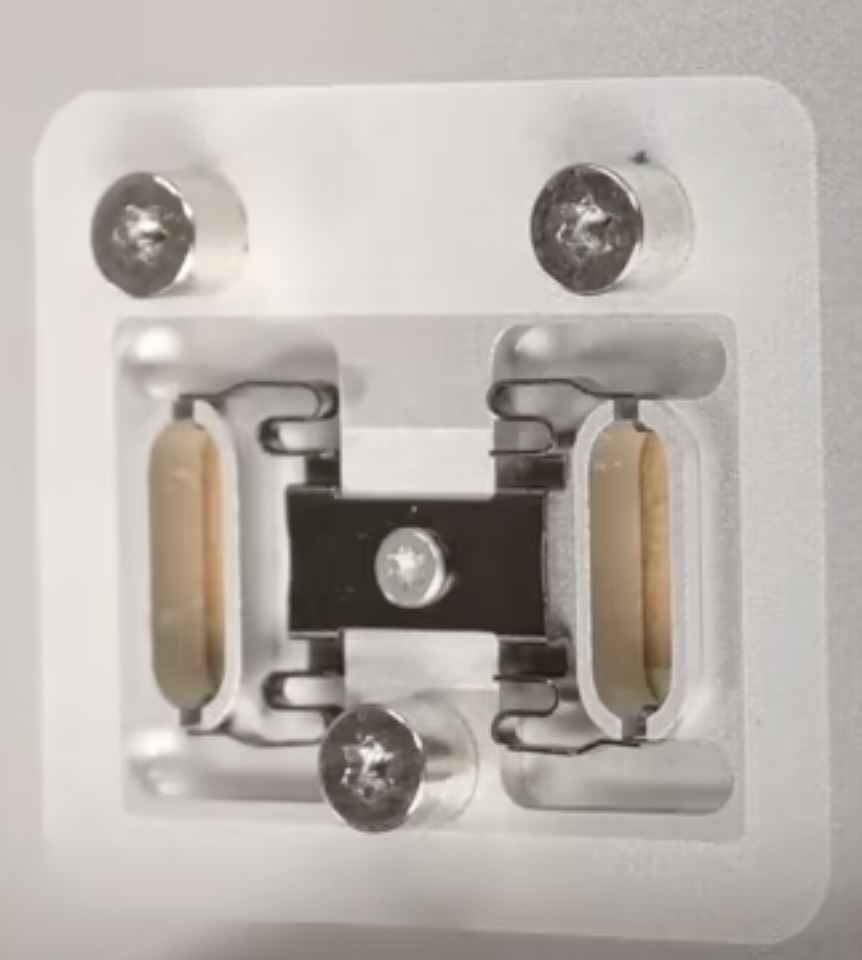

The retaining springs that Apple fit inside the external slot of their TB3/4/5 ports is at the top and bottom of their vertical ports.
So for Apple cables the overall width of the metal sleeve isn’t a factor in the design. It’s the exact dimension of the metal sleeve at the top and bottom (on a vertical slot).
If you use pliers to squeeze the long axis of the sleeve you end up loosening the fit…
There is a second pair of springs inside the USB-C plug that again holds the long axis of the inner protrusion that insulates the contacts.
Edit: I can't find a pic of the computer ports, but this shows the retaining spring in the Studio Display's ports:
