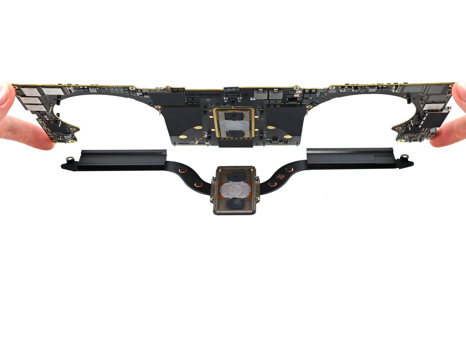

On a intel Macbook you'd just apply a few layers of conformal coating around the die then build a dam around the die with some foam so if the liquid metal shifts, it cannot make it onto the motherboard. however with the M1 family of chips the RAM chips seem to be part of the IHS. I would imagine there would a small gap that could allow the liquid metal to get under the RAM and short something out. You could use conformal coating or nail polish to fill those gaps, it looks like you'd have to be pretty precise with this though as the RAM chips need to make contact with the heatsink for cooling.
Looking at the picture below, it seems the mount for the heatsink is made of aluminium and the original thermal compound has spread onto it which would compromise the aluminium if it were liquid metal.
The IHS could be plated copper or aluminium, until someone scratches one up to see, we won't know.
It's probably not impossible but it does seem more challenging than an intel Macbook.
