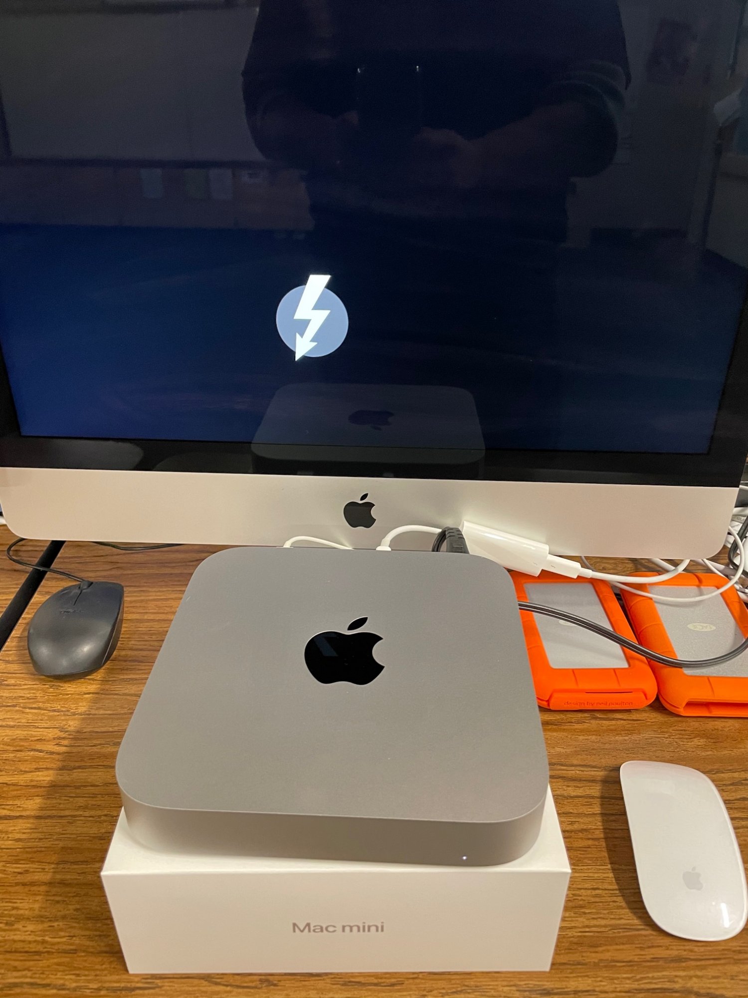

Did you find a way around this at all? I have just bought a M1 MM to use with my mid 2011 iMac 27" and am a little worried that its the MM that won't play ball!!
Cheers
I don't have an M1 Mini, but evidently they will not work with target display mode on the iMac - see this:
Thanks for that, I read through a number of posts and threads including this one, this is the only one I found where the M1 was the cause for failure, all others seemed to fail because of wrong iMac or wrong macOS or wrong cables.
