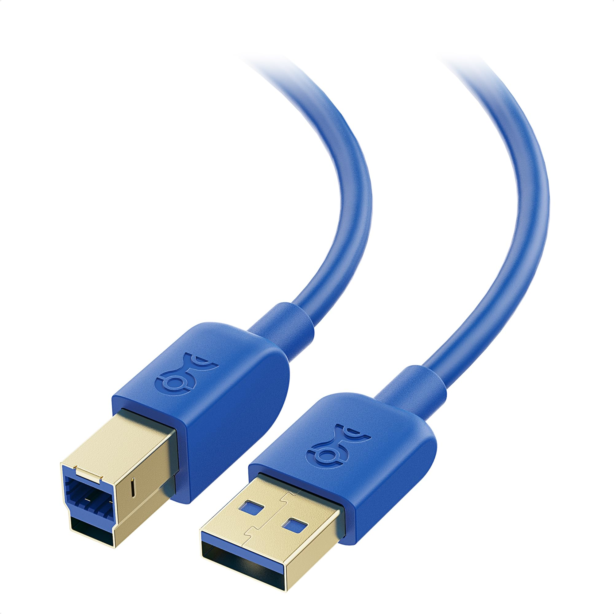

I have an "Icy Box" SATA 4 bay USB 3 hard drive tower. The cable that came with it looks like this:

Can I plug the Icy Box into the other USB 4 /thunderbolt port, and will it be faster than the USB A port?
Depends on specs of the enclosure. Some of the Icy Box/Dock 4-bay enclosures are USB 3.0 5Gbps, which means using the TB port won’t be any faster. What the specs of yours?

You should get a significant speed-up - vs. the USB 2 on your old Mac - just using USB-A and getting “5Gbps” USB 3.0 speed.
Even *if* the enclosure supports 10Gbps, *and* you are running SSDs rather than mechanical HDs then you’re going to see diminishing returns going from 5 to 10 Gbps - so it’s probably not worth the bother. SATA tops out at 6Gbps anyway, and mechanical HDs rarely get close to that.
