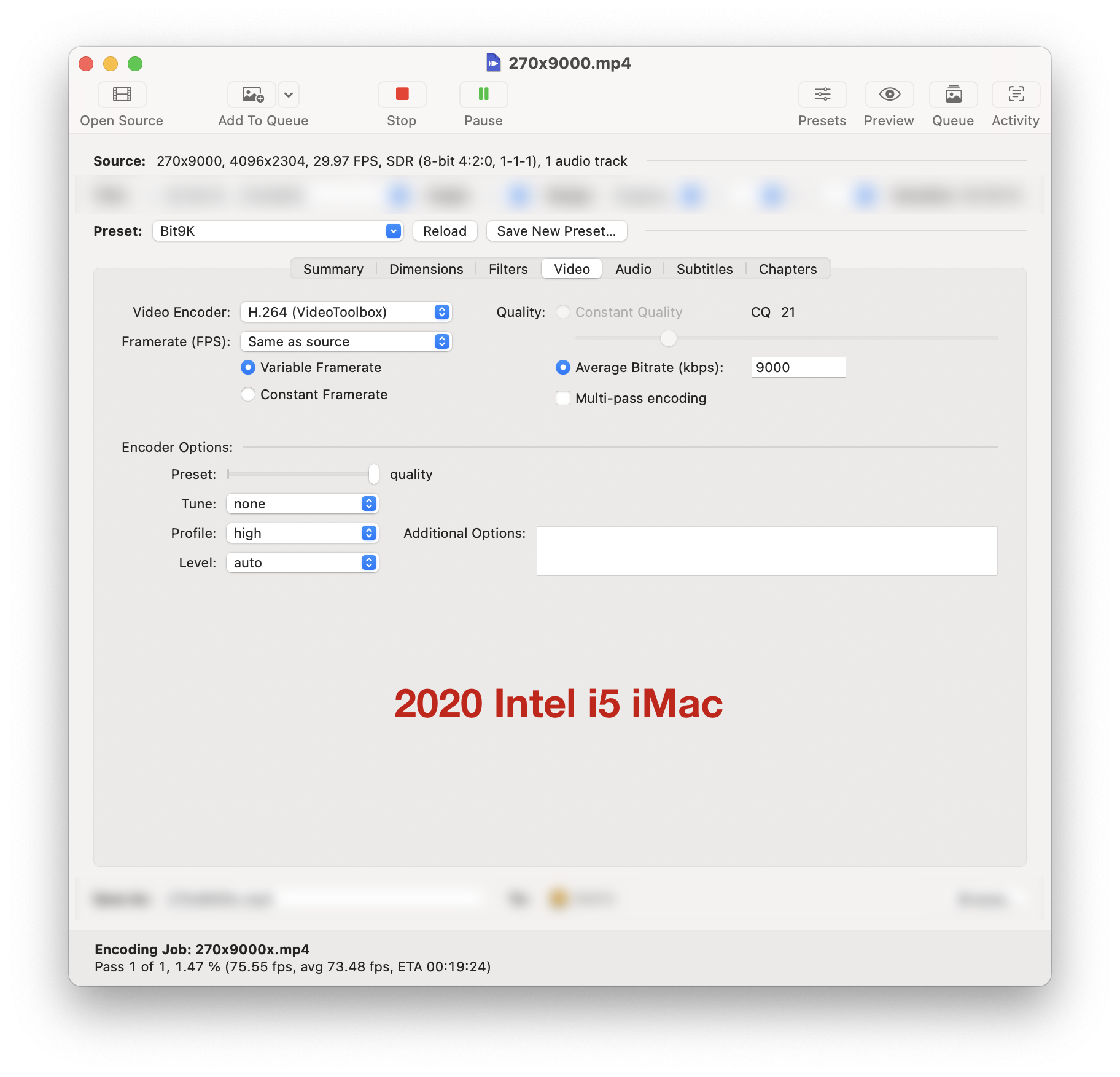

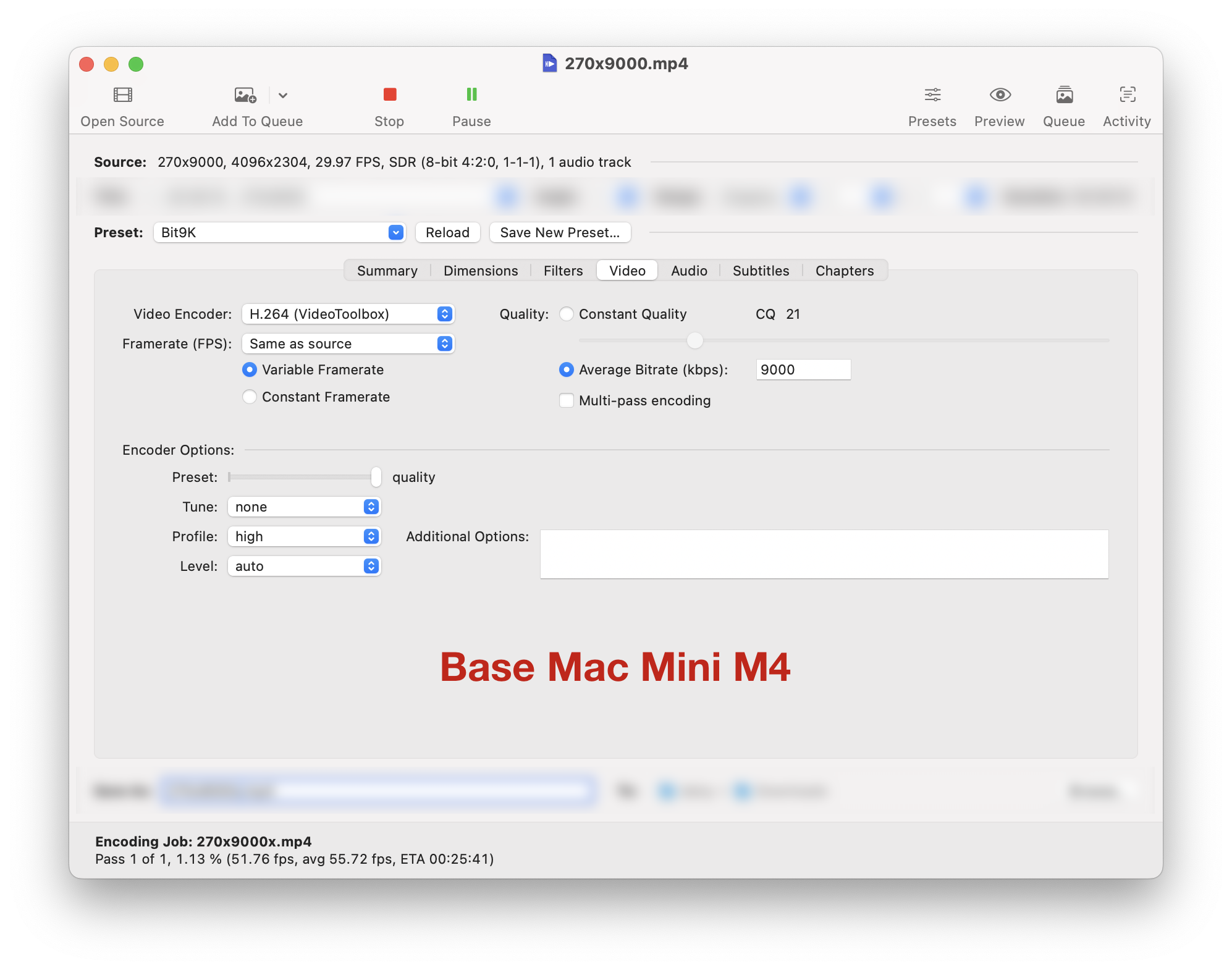

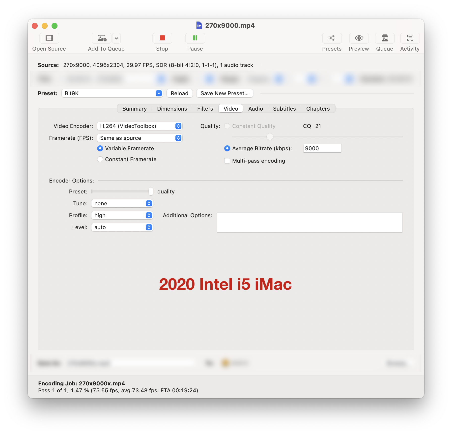

Got my base M4 Mini a few days ago and I'm slightly disappointed with its hardware encoding performance using handbrake.
Testing with a 4K DCI input and same preset across both machines, I get only 50-55fps max on my M4 Mini.
The 2020 Intel iMac with a basic i5 10500/Radeon Pro 5300 encodes the same input at over 75fps.
Not sure if Apple is employing AMD VCE or Intel QuickSync Video encoder on the Intel iMac, but I'm surprised it can still hold it's own compared to M4's built in hardware encoding engine.

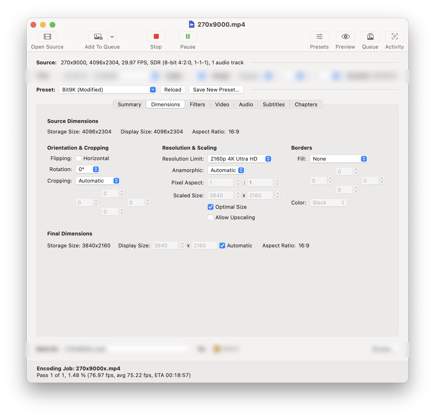

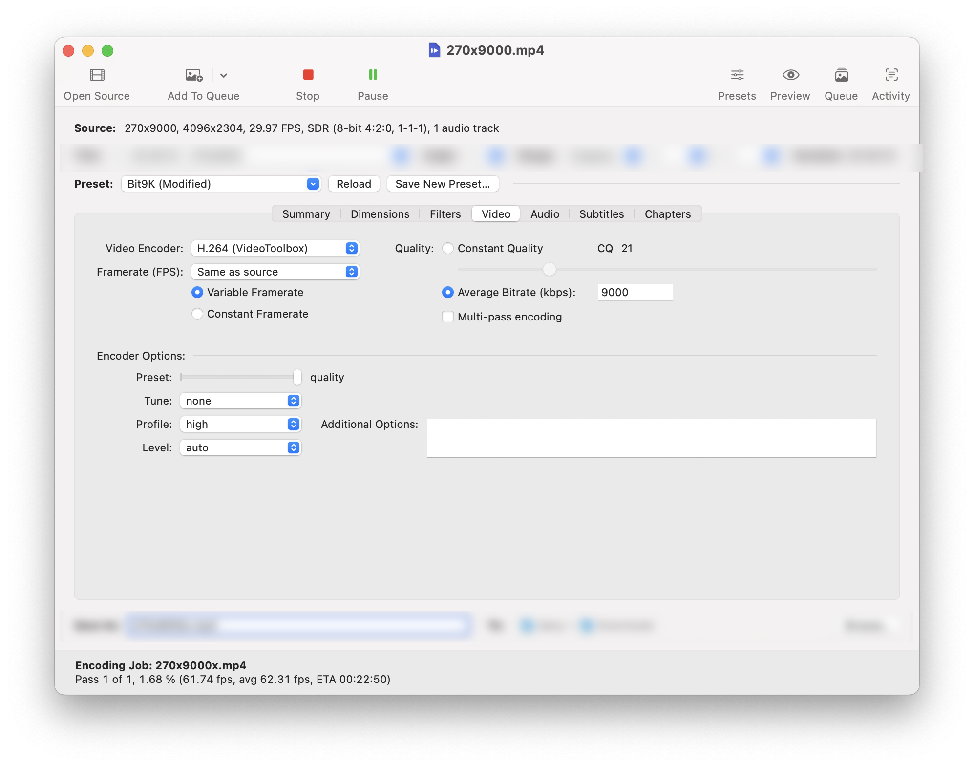

Setting them both at 4K limit makes no difference. M4's hardware encoder is still about 30% slower.
The Bit9K custom preset is basically everything else turned off with just H264 videotoolbox encoder and 9K bitrate, as you can see in that screenshot.

Just did a 4096x2304 to 4K UHD with the settings I could glean from you and get ~154fps on an M2 Max and ~77fps on an M1, so clearly something is off with your settings.
Curious the results form each system with Profile=baseline or main? Maybe M4 less optimized for Profile=high? Interesting results regardless.
Try with the default preset.
Well I'm running the same version on both machines with default settings and a preset imported directly without changing anything else.
Did you test with H264 or H265 videotoolbox? When doing H265 with the same input, M4 was able to encode at 102fps, but the output quality was much worse at same bitrate than doing H264->H264.
When doing H264 at 4K UHD limit, it's actually more around 20% difference.
M4 with same preset at 4K UHD:
Intel with same preset at 4K UHD:

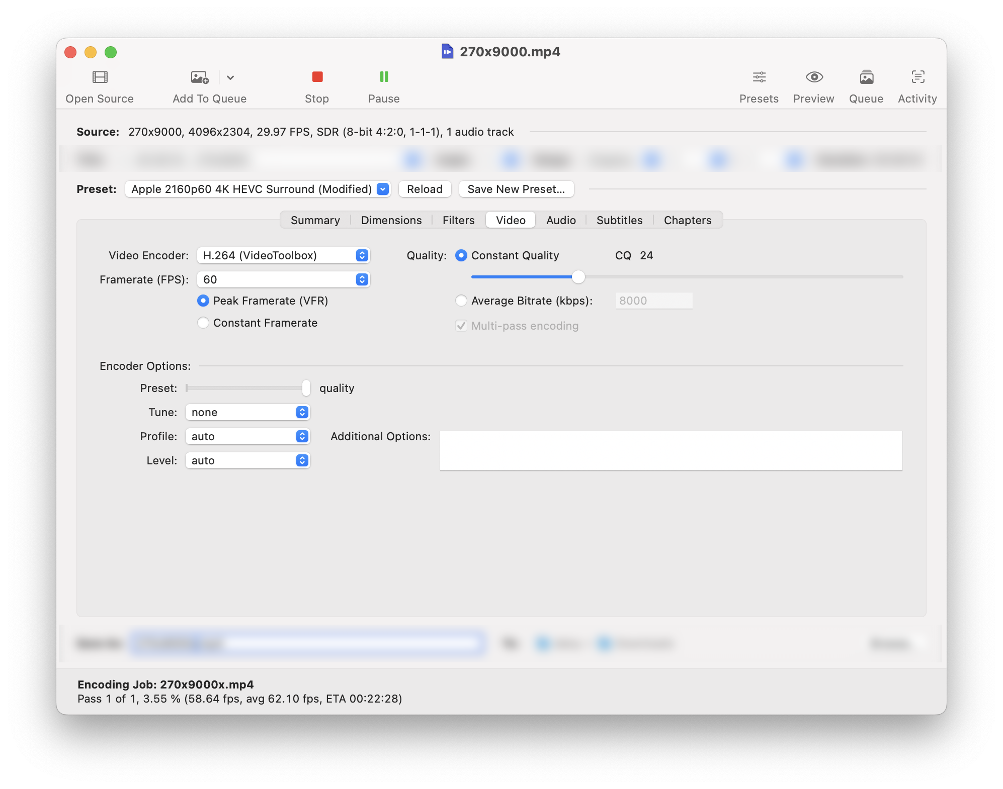

Also tested M4 with default Apple preset modified to use H264 videotoolbox:

Did some more digging and it seems that for 2020 iMac or any other T2 equipped Macs, Intel QuickSync isn't used at all. The T2 chip handles all the hardware video encoding, which is basically the Apple A10 chip.
Edit: User bzgnyc2 basically confirms my findings in the above post.
Makes no sense that A10 would be faster than M4 chip at H264 hardware encoding.
Ah, that makes sense in terms of the T2. I stand corrected (never had a Tx Mac myself).
But equally this is fixed function ultra low power hardware and isn’t likely to have changed much in the intervening years. I don’t think H264 optimisation is much of a target these days and I doubt Apple felt the encoder needed much by way of changes.
As for why it would perform better on your iMac, I have no idea, but it wouldn’t surprise me if the encoder blocks were largely similar on both machines and we’re seeing some kind of software quirk.

VideoToolbox on Apple Silicon has got two quality settings, while on Intel setting "performance" or "quality" will make zero difference, another difference is that on Apple Silicon supports the constant quality mode, and on Intel it doesn't.
Plus those are still two totally different hardware encoder, the resulting quality might vary a lot.
Anyway, the bottleneck might be in the decoder, some things are still not optimized for ARM yet.
It's a CPU monster only when you're using software encoding. Videotoolbox only engages the hardware encoder and unless you're using any filters, the CPU isn't used at all.
