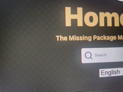

I use a M4 Mac mini with a Xiaomi A27i display. I notice that some dark colors cannot be shown properly. There are squares flashing or dancing. For example this is a picture from the background on the brew webpage.
It seems like there is an imbalance between red and green. If I try to calibrate red and green though the display’s settings this effect is disappearing from that particular color but it appears on another (for example on Finder’s window dark background).
Is this a macOS incompatibility or a display issue? Have you seen these squares again?

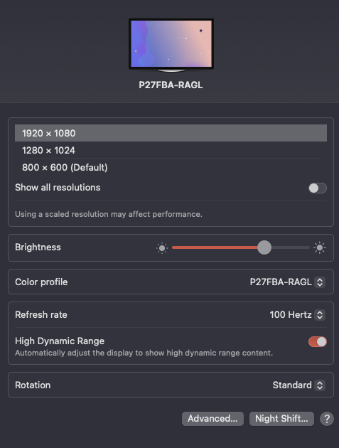

I enabled HDR option on the display and turned on “High Dynamic Range” in System Settings. Now it looks fine and I can also adjust the brightness using the keyboard, but the display doesn’t allow me to adjust anything. Also I notice that the default resolution is 800x600 and not 1920x1080. Is this normal?
Understand that when MacOS says "resolution" it really means zoom. So 1080/600 = 1.8, or 180% zoom. This is just MacOS's way of picking a size for the display elements on the desktop and in windows, etc. You can sets the zoom ("resolution") to anything in the list (and more if you use BetterDisplay), but the results may not be aesthetically pleasing to you.
However, that MacOS thinks it's a 4:3 display (800x600) sounds to me as if there is compatibility issue.
As for color issues: are you using the HDMI cable, or a USB-C cable (for DP over USB.)

I tried changing all settings (including refresh rate) and only enabling HDR was able to eliminate it. I don't have a USB>Display port cable at the moment. I might get one to try that too.

This is a bad, 6-bit monitor with FRC (flickering is the result of a bad FRC). There is no HDR when the display brightness is only 250 nits. It is also unclear what is going on with the resolution. The system should offer 1920x1080 by default. I suggest returning the monitor to the seller. Replacing the cables will not help, this is not relevant in Full HD resolution.
The issue I described in the first post is called GPU dithering in BetterDisplay and can be eliminated by disabling it in "Color Mode" menu.
I tried many different HDMI cables and a cheap USBc to Displayport and here are my findings:
- HDMI: The display turns black momentarily
- USBc-DisplayPort: The display turns on when computer Dark Wakes (doesn't show anything but I get a 10" countdown on my display until it turns off again).
HDR turned OFF on display
✅ - HiDPI working
⚠️ - need to disable GPU dithering BetterDisplay
❗️- Brightness control with 3rd party app or using display's buttons
HDR turned ON on display
✅ - no need to disable GPU dithering with 3rd party app
❗️ - HiDPI with HDMI cable working only on low resolution
HDR disabled on MacOS​
❗️- Only software brightness control​
HDR enabled on MacOS​
✅ - native brightness control without 3rd party app​
❌ - weird artifacts with USBc-DisplayPort cable​
So now I'm sticking with the USBc-DisplayPort cable, HDR OFF and using BetterDisplay (brightness control, disabled GPU dithering, enabled HiDPI)
