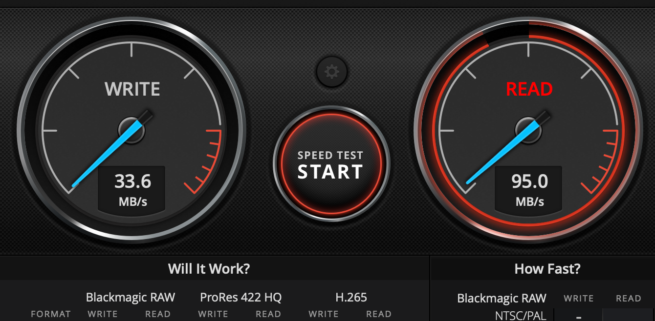

Hi,
I just tested one external SSD connected to rear USB-C, and was getting read/write speeds around 800MB/s,
this is what I'm getting when using front port:
I've noticed that even SD card reader is much slower if connected to front port, how can those front ports be this bad?
Shouldn't the SD be the bottleneck?
Do you guys have the same issue?

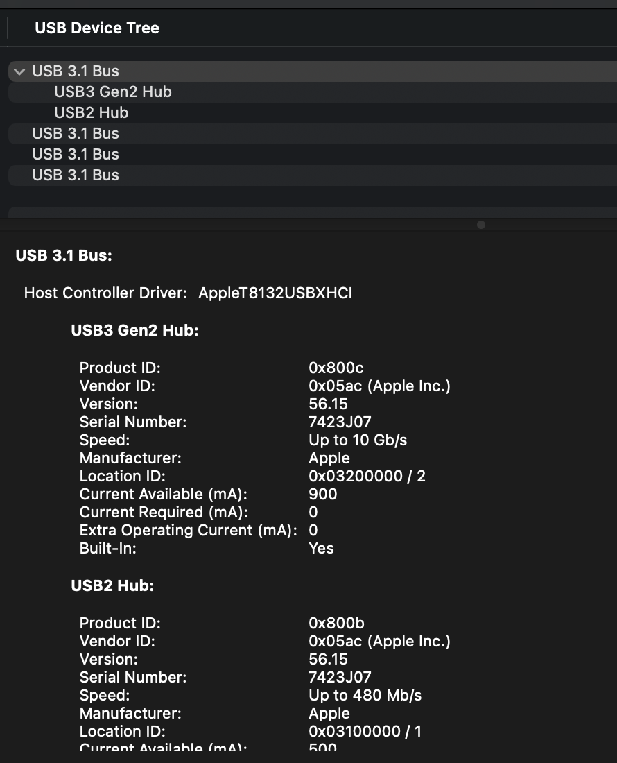

I've tried disconnecting all external drives, am I supposed to see USB2 hub in system info?
Every USB 3 hub contains a USB 2 hub because USB 3 and USB 2 are totally separate connections - they use different wires in the USB cable.

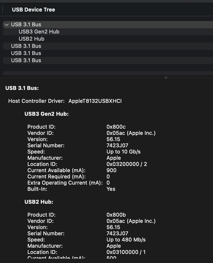

Hi,
Just to compare I did a test on my Mac mini M4 Pro front USB-C port with USB 3.1 enclosure APFS formatted SSD with Realtek RTL9210B-CG chip. Getting speeds over 800 MB/s. Real world transfer speeds with USB 3.1 should be around 800-900 MB/s so I see no problem with the front USC-C port on the Mac mini.
