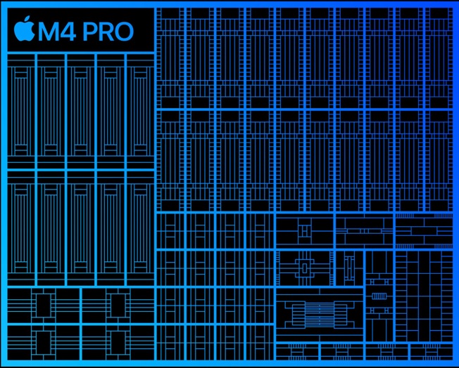

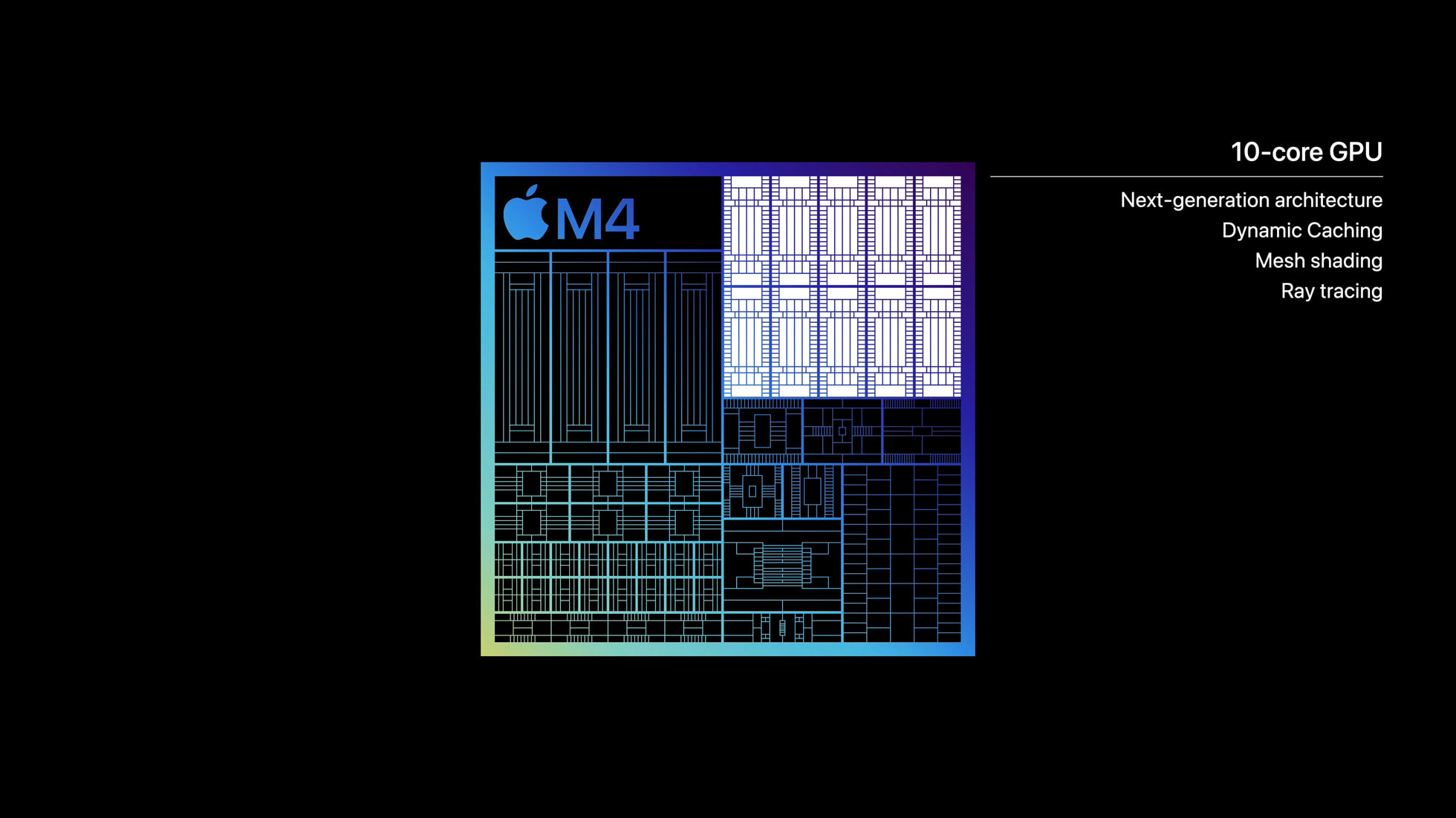

You pointed it out yourself, power metrics only reports back CPU, GPU, and ANE (i.e., NPU) cores power consumption.
Although, of course, there are other controllers, processors, etc.
On the die, we also have the Media and Display Engine:
And at least one of those other unidentified components is the SSD controller. Another one would be the Secure Enclave. Other components include DRAM chips/modules, NAND chips/modules, network/communication controllers/transceivers, fan(s) controller, fan(s), etc.
Obviously, the M4 Pro (and Max) have different layouts.
The CPU cores taking up the entire left section.
The GPU cores cluster amassed beyond the top-right quadrant.
The NPU/ANE cores than get slotted in at the bottom-center, nudging into the intersection of CPU and GPU cores.
The Media and Display Engine is once again bottom-right.
