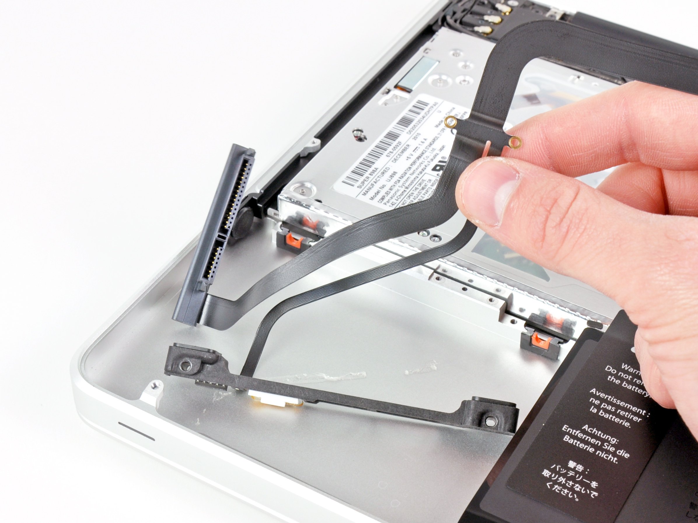

Are you sure the SATA drive cable isn't defective?
It’s a good shout. Is that common? Guess I can try open it up and have a look. What am I looking for? Loose connection? It’s basically the plug that plugs into the HD from main board yes?
The cable itself is known to slowly degrade over time. I've replaced the drive cable in the 2010 to 2012 13" Pros over the years.
I can have a look I guess. Not sure I’d know of it was broken. Can you show me a link to one I can purchase. If it’s a few pound maybe I can try that.

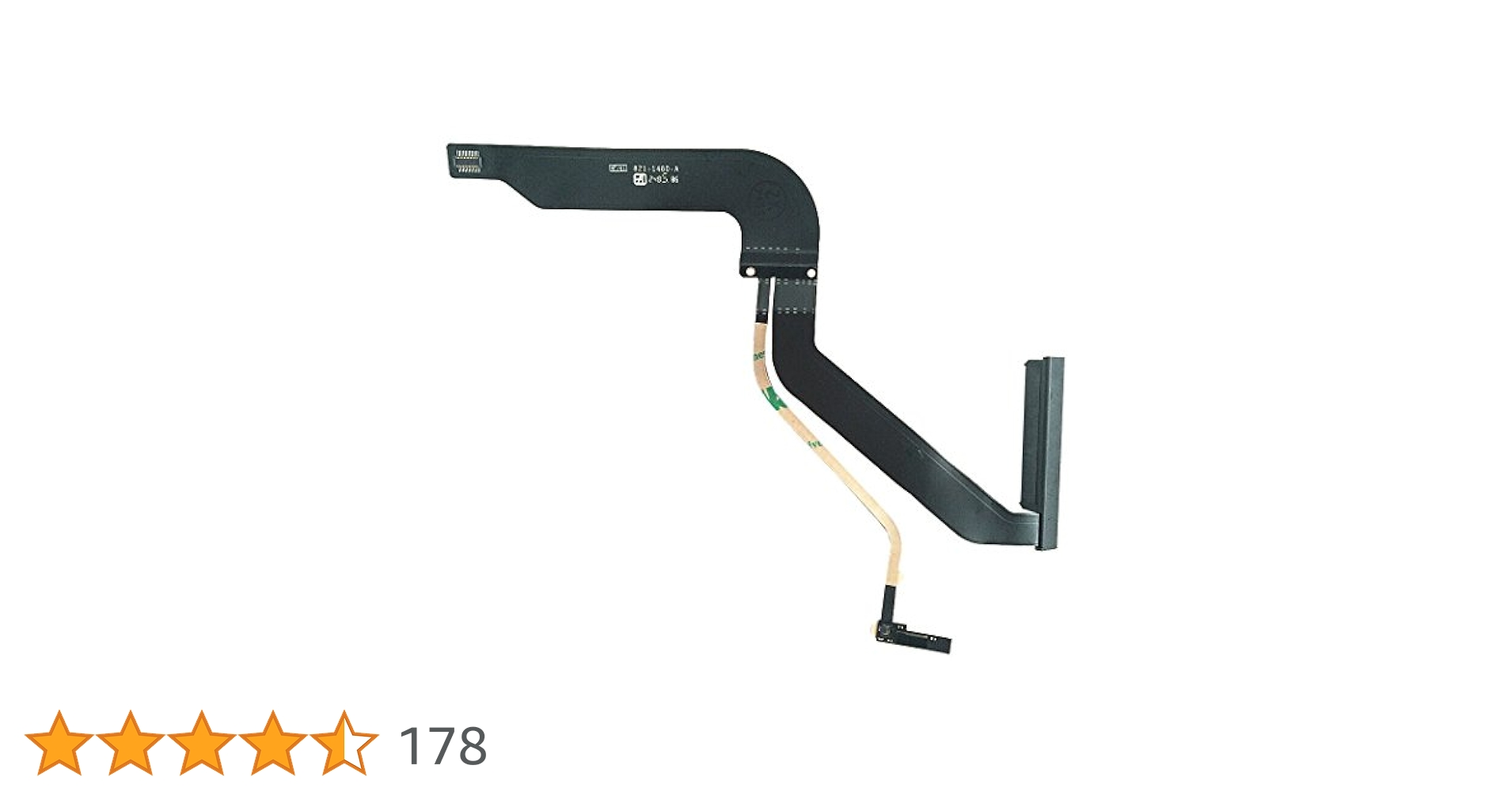

Is it easy to replace this cable? What is the technical name for it ?
I don't recall the fan blowing at all times it but's possible.
Does that cable work on 2011 too? I’m in the Uk but sure I can find same one.
