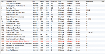

Ran a verify of the disk, received no errors.
Ran the Smart Utility app and it is showing a Failing in yellow.
Says it has 2 pending bad sectors under attributes.
Under Errors it shows 20 total errors and that they are uncorrectable errors
When I click "show all" it only shows (5) READ DMA EXT errors, with 16-20 shown all showing the exact same thing.
What is causing those errors? The computer works fine and I have had no issues what so ever.
Here is what it shows under attributes when you click "show all". I took a screen shot.

2 bad sectors on HDD, best to get that replaced. Due to how HDD technology works (spinners, platters, needles), even something as simple as wear-and-tear over time will cause them to fail. As it's a machine from 2009 it's not hugely surprising.
The errors are hardware so nothing you can do to fix, beyond replacing the drive.
As you'll be replacing the HDD anyway you may as well throw in an SSD instead to give your Mac Mini a new lease of life.
Problem is it is a 320 HD upgrade then the original that came with I guess, as i bought it like that. Will the errors get worse? Or is is something I can live with as I backup stuff constantly. Don't really have the money to go get a new drive at this point in time, maybe a few months from now.
With corrupted sectors the computer will reallocate to other sectors, so try to keep as much free space as you possibly can as to not make the problems worse. It's something you can live with certainly, though any issues with the computer running slowly/crashing/freezing will likely be caused by the HDD.
You can replace with any old SSD (500GB, 1TB), so don't worry about it being 320GB.
If you've got a Time Machine backup you can restore that directly to the fresh SSD, so it'll be just as you left it.
