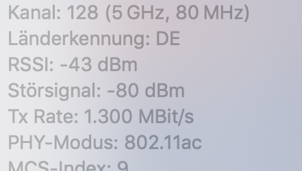

It's also funny, that right now I am having a 14 Mbit connection...which is crazy slow... so it's really temperamental...after a reconnect it is 1.300 Mbit again...
Alt-Click onto the Wifi icon in the menu bar to get this information.
Most likely, I will try to get a wifi usb stick with a good antenna. I do not like the repeater idea, since a repeater always consumes power and takes up at least one power socket...
I know the alt info. It says 144 MBit/s, but I am pretty sure those numbers are theoretically, because with other devices I can view netflix and full hd youtube, but here it took me about 10 minutes to download 80 MBytes...
