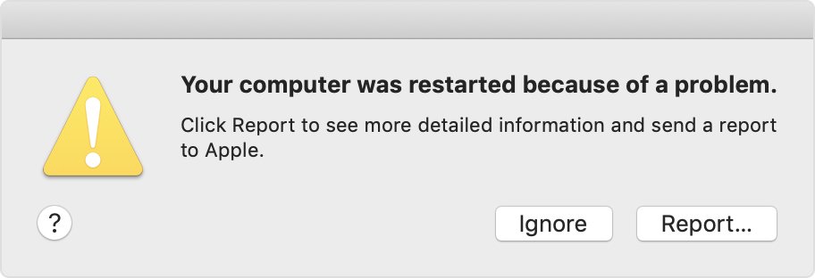

I waited till now, thinking 15.2 would be stable but since the update, the machine just keeps getting kernel panic and rebooting. I disconnected all peripheral, no change.
Restarted in Safe Mode and ran EtreCheck, I'll post it below:
I'd be grateful for any tips.

  1. Replace RAM with original sticks.
  2. Rogue Amoeba ACE audio plugin no longer supported. Uninstall.
1. The RAM hasn’t changed in years, why would I replace it due to an OS update?
2. I’ll try that, thanks
Frequent kernel panics are sometimes indicative of hardware issues. Memory is the only user upgradable component of that model MM.
Can you save and post the report?
https://support.apple.com/en-us/102382
Use Apple Diagnostics to test your Mac
https://support.apple.com/en-us/102550
I appreciate your advice but are you seriously suggesting that my RAM developed a problem after years with zero issues, at exactly the same time as I upgraded to MacOs 15.2?
Reactions: benwiggy
I ran the hardware diagnostics, no problems found, tried all sorts of tidying up, removed an old kernel extension etc.

All to no avail, here is the latest EtreCheck Report:
The EtreCheck report is useless. I meant the report generated by macOS after a reboot.
"Click Report to see more detailed information"
And inline:
panic(cpu 0 caller 0xfffffff0202c7ce0): SEP Panic: :sksm/sksm: 0x0007bf18 0x00028a0b 0x0001f9e1 0x0002fdaf 0x00024909 0x00024877 0x00048225 0x00047ea5 [nrvho]

If the machine works in Safe Boot mode, then it's likely caused by a third-party extension or other software that's loading in. Disable all that stuff in the EtreCheck report, and check whether it's up-to-date and compatible with Sequoia before enabling and testing each one in turn.
I have removed everything and still the same, think I'll have to go back to the previous OS:
