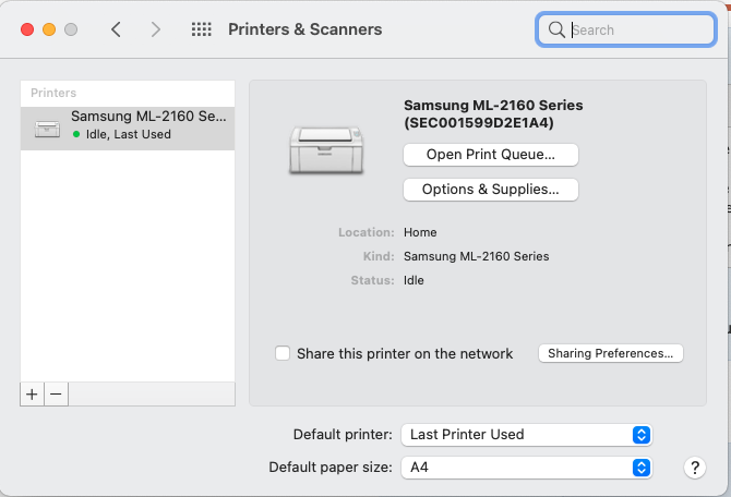

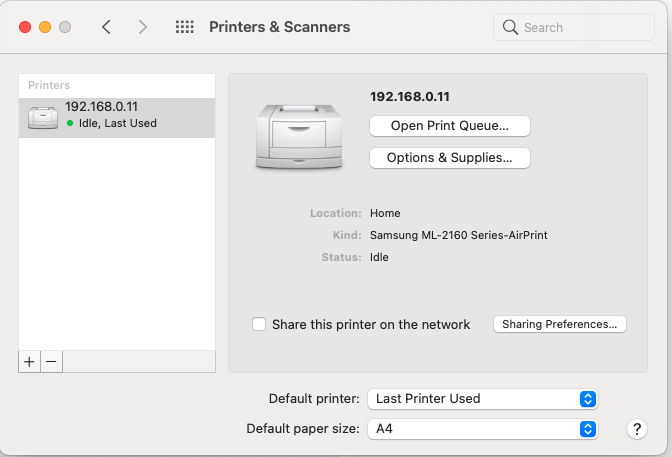

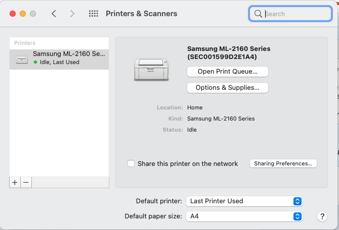

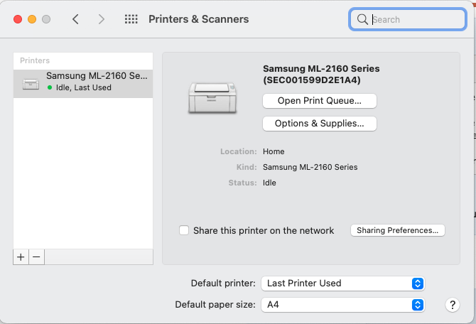

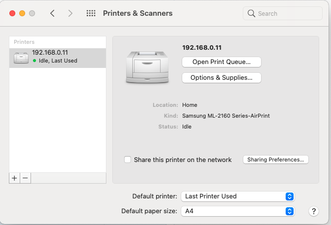

1. Printer problem - I have older but still fully working Samsung ML-2165w which works fine connected to windows PC/2 android phones and 1 iphone but can't get it to work with this mac, when I go add printer in printer and scanners I can add IP address and choose Protocol, I did try AirPrint and IPP, both will show the printer is at idle but when you try to print from pages just won't print, in screenshots below you can see under "kind" is able to even get the printer info I'm also able to enter samsung syncthru web service via options and supplies.

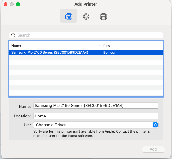

I also try wifi direct and mac can see the printer but then is asking for drivers and samsung is not providing up to date driver.
Anyone could possibly advise?

Without a driver for your printer you're not going to be able to do much, if anything.
You can try the open source "Gutenprint" drivers which may work. They don't specifically list your printer but other Samsung printers from that series are listed. You have nothing to lose by trying:
I have managed to find a driver now and is finally working after 3h of trying from here
Unfortunately Samsung doesn’t use PCL or PS. As far as I can tell they use SPL for their printer language. The splix/CUPS port for macOS I found is very dated and unlikely to work. Unless one of the Gutenprint drivers for another Samsung printer works. I think it’ll be time for a new printer.
I managed to find working driver, I posted reply early on but post needs to be reviewed by moderator due to link.
