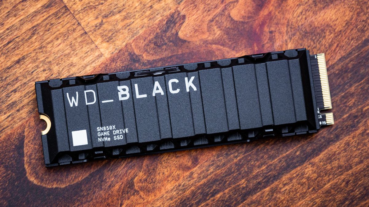

Note that it is normal (expected even if not ideal) for modern consumer SSD to go fast for the first the ~ 50GB and then slow down dramatically after that. Scroll down to "Sustained Write Performance and Cache Recovery": on this page:
As such when I look for an SSD, I specifically search for those with high sustained performance (after prioritizing high TBW and low peak power draw) rather than peak performance. For external TB3/etc drives, performance above 3GB/sec is inaccessibly anyway so I don't care about that. But thermal throttling, non-cached slowdown, and especially drive failure will slow me down.
