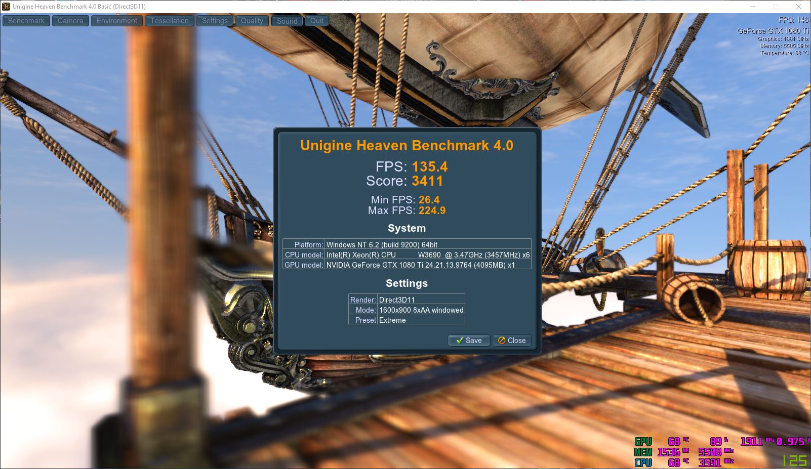

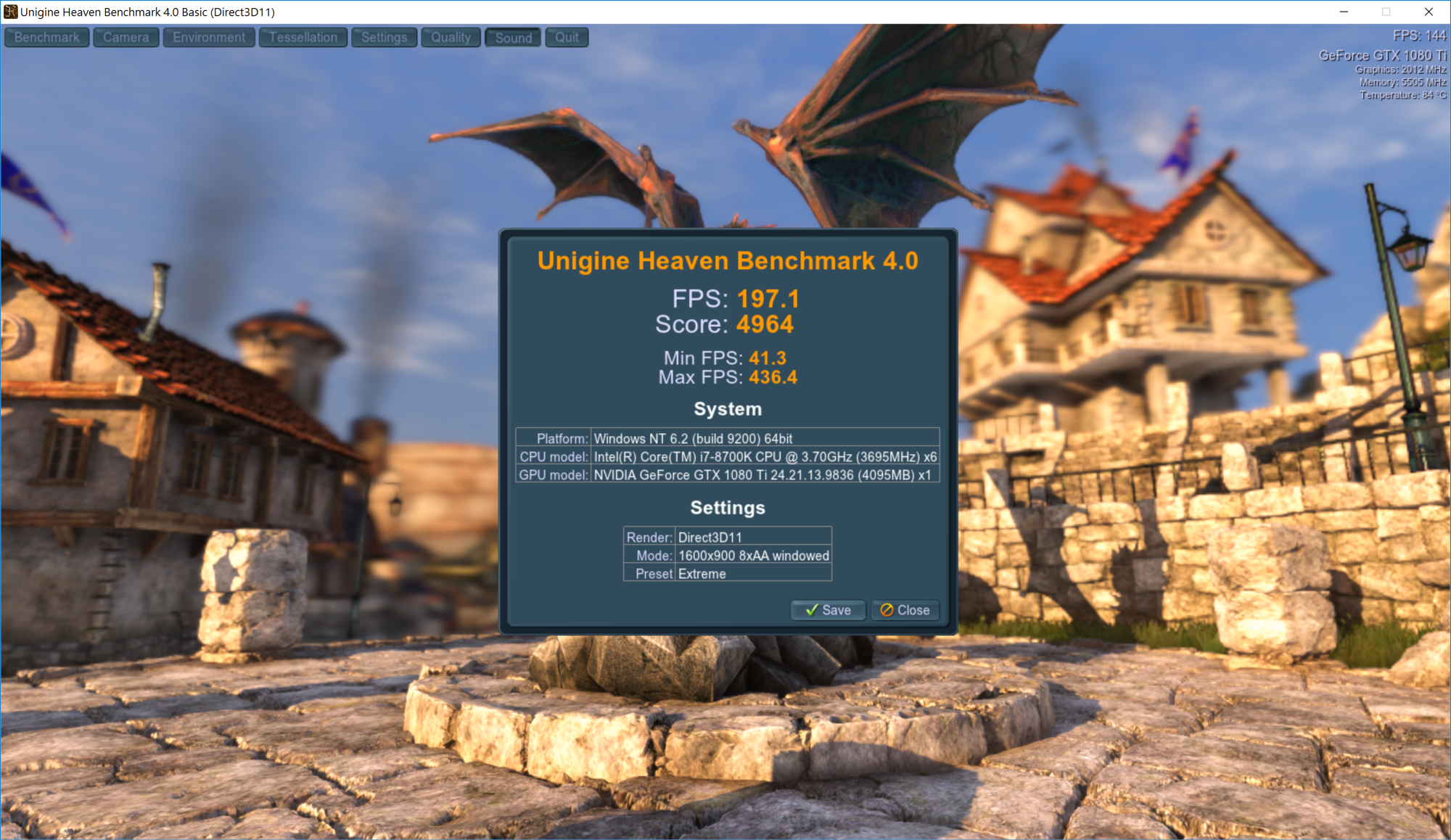

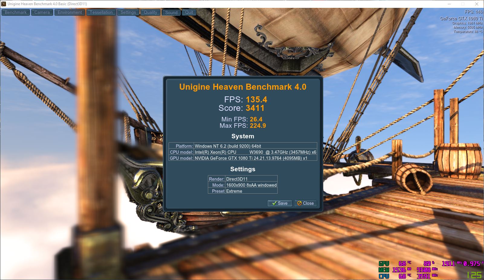

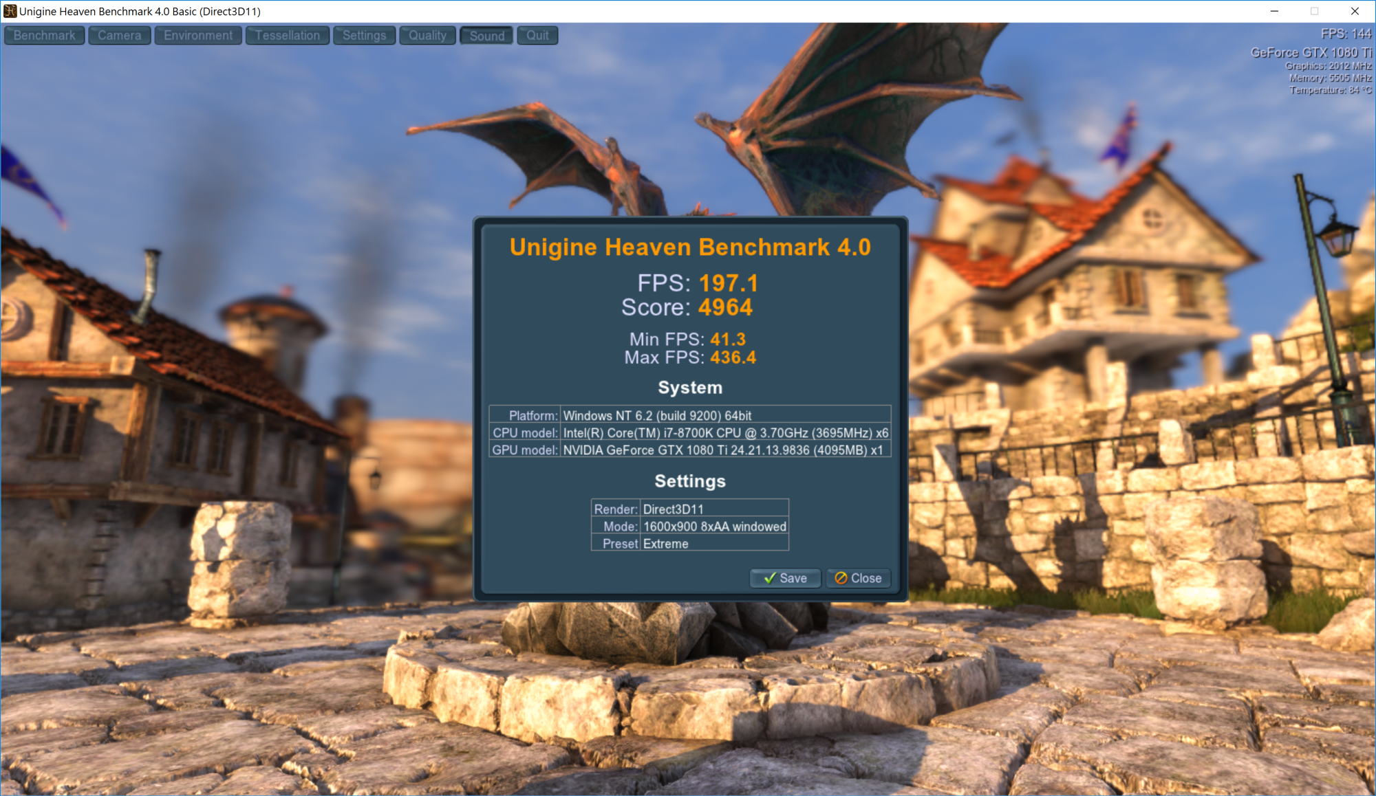

I have a 8700K gaming PC, and a W3690 cMP (same single thread performance as X5690). And I have a GTX 1080Ti. I put that into the my 8700K PC, and the cMP, which produce the following benchmark results.
As you can see, I use the same preset, same OS, same GPU, same benchmark. The main difference is the CPU.
With 8700K, I got almost 200FPS.
With the W3690, the same GPU with the same OS, can only do 135FPS.
This example is pretty good to reflect what may happen when you play modern games on the cMP. The same GPU may work noticeably better in your 7600K PC.
