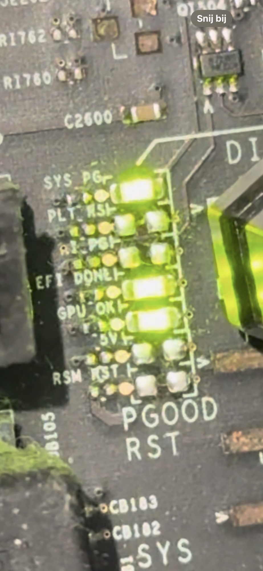

What do the diagnostic LEDs say on the backplane and processor boards?
Do you have another GPU available? If so, try swapping them for awhile. The 280X is quite old today. If it's failing (or HS grease dried out) that could explain all symptoms.
The 5V LED in the photo above ^ keeps flashing
The service manual doesn't mention this light blinking - just ON or OFF. As you've already replaced the PS, I'd suspect an excessive draw on the 5v supply. Try unplugging all the SATA devices - HDs and optical drive(s). See if the 5V LED becomes steady. If so, add devices back one at a time until you find the problem device.
If the 5v LED doesn't settle down, even with all SATA devices unplugged, I'd suspect the backplane board. Though you might give the pins and socket a close inspection, between backplane and processor boards. A foreign object (or bent pins) is a long shot, but would cause headaches.
Hey man, my bad. It's the LED between 'GPU OK' and '5V' that is flashing. That's the LED of 'GPU OK', right? I might have to replace the GPU.
