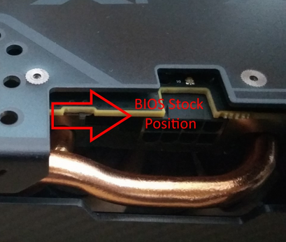

Also make sure, which was weird for me getting stuck. I had to switch for stock to gaming, or vice versa, can't remember?, but switch it to the opposite you have now the RX580.
More than likely you might need Alex to reconstruct.
