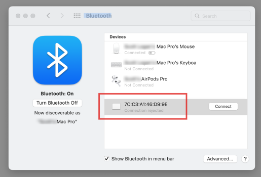

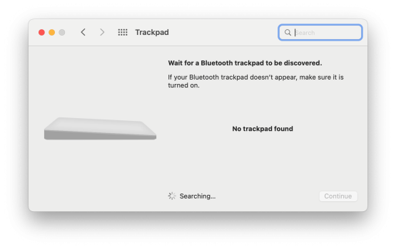

My trackpad stopped working in OpenCore (OCLP) Monterey— it still works fine in Mojave.
When the trackpad stopped working I deleted it from the Bluetooth Preferences pane and it was quickly discovered again, but after several seconds it is rejected (screenshot).
The batteries are good and I've restarted the Mac. I've tried turning the trackpad off and then on during the discovery process— hoping it would be seen and accepted. Nope.
Any suggestions would be greatly appreciated. Thank You!

I would change batteries anyway, even if you are sure they are good (unless you've tried that already). That will also let the trackpad fully power off, which might make a difference.
You should do an NVRAM reset on the Mac as well--if no change doing it once, then hold down the key combo through 5 full restarts and see if that helps.

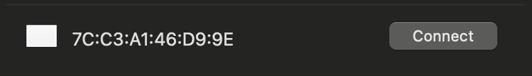

Tried to pair the trackpad with my 2013 MacBook Pro... same result. The same Mac Address appears in the Bluetooth preferences window, just as it did on the 5,1— but when clicked on, pairing is rejected after a few seconds.
Seems to point to the trackpad pooping-out?
Seems maybe that's the case. Did you try pairing while holding down the power button on the trackpad? Details.. Thank you.
"Did you try pairing while holding down the power button on the trackpad?" Yes, thank you.
The thing that's odd is that when the trackpad shows-up in Bluetooth preferences it's listed as a 12 character Mac address, rather than something like, Scott's Trackpad?

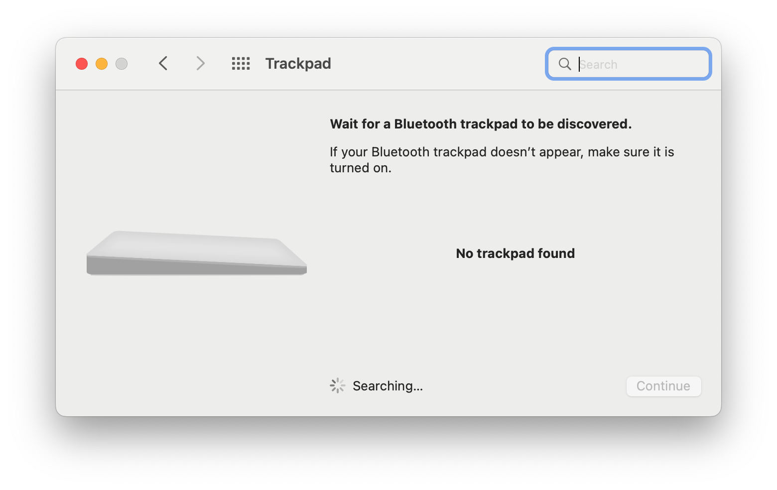

The fact that the trackpad is still functioning as normal in Mojave is interesting. I wonder if it's not going into pairing mode at all. Can't believe I didn't ask this earlier, but what is the LED on the trackpad doing when you hold the trackpad's power button down? It should either come on and then go off (meaning you just powered the trackpad off) or it will blink, meaning it has entered pairing mode. If the light doesn't come on at all then perhaps the problem lies with the trackpad's power button.
You may want to test pairing it with your MBP again. In that case, you should turn your Mac Pro off completely (or unplug its power cord to be sure). The issue sometimes with trying to pair those to a different computer is that they end up reconnecting to the one they were originally paired to if it is in the vicinity and thus the pairing process fails. Supposedly you can prevent that by holding down the trackpad's power button during the whole pairing process, but seems to be it would be easier to just power off the Mac Pro while you try. EDIT: If that works and you can pair it to your MBP, then you can try pairing it back to your Monterey install (again, make sure you turn off the MBP first).
YOU, my good man... cracked the code!!!
Per your suggestion I shut down the Mac Pro and turned-off the trackpad.
Shut down the MBP and restarted, just for good measure.
Started the MBP and the trackpad.
The MBP didn't immediately see the trackpad but with 10 minutes of fiddling it finally connected.
Then I shut down the MBP and trackpad.
Then I started the Mac Pro and the track pad and the DARN THING CONNECTED. Using it right now!
I was aware Bluetooth pairing can sometimes "stick" to a device they were previously paired with, but it never occurred to me that might be the case here?
