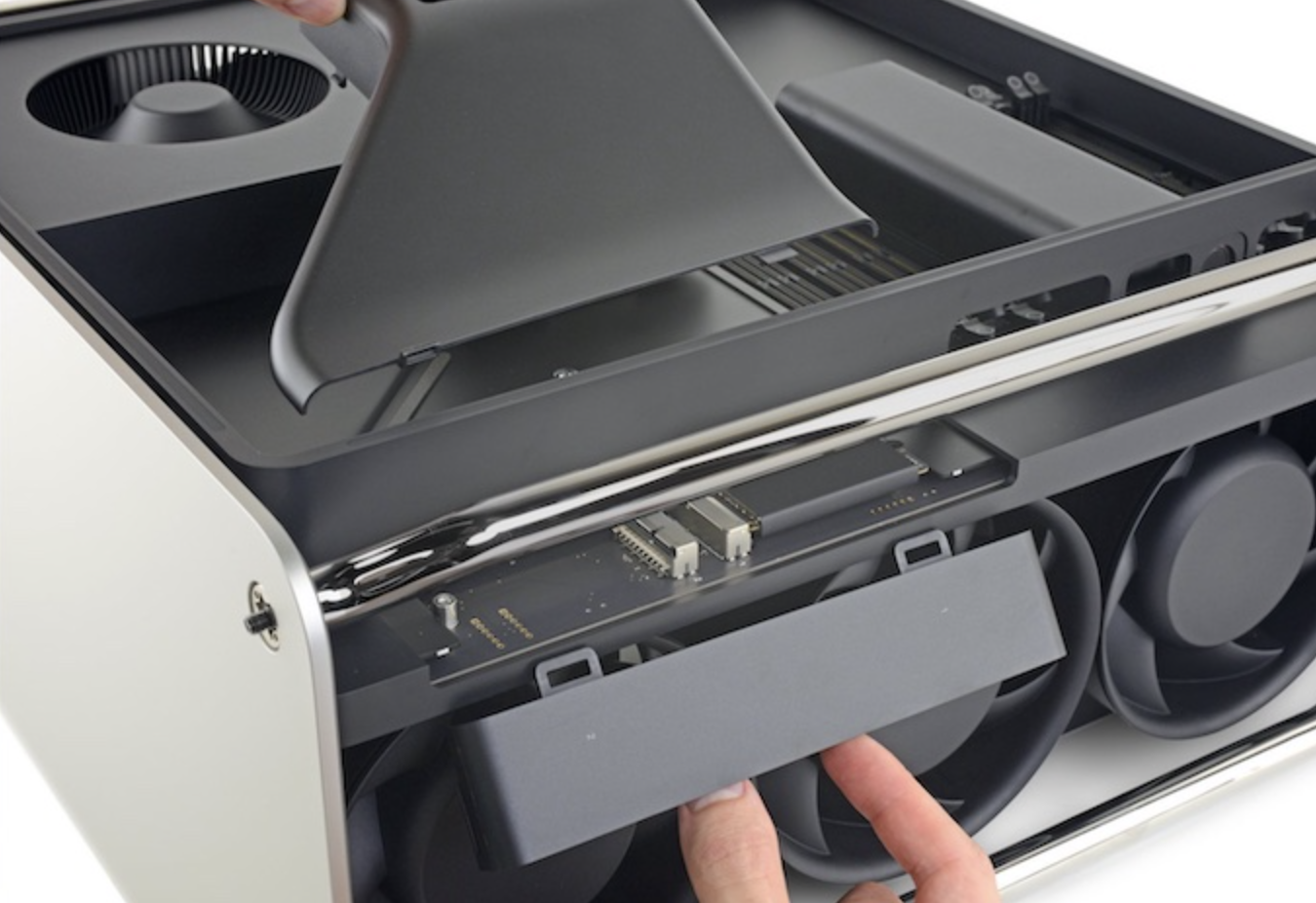

A Mac Pro 2019 does not have Fusion Drive or a SATA SSD.
You can have from 256GB - up to 8TB SSD
