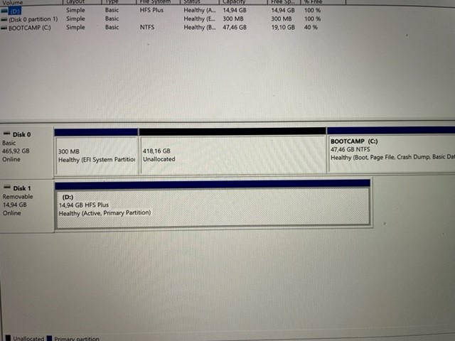

I have a Macbook retina (2015). I love this machine for what I have to to and it is as new.
I have (had...) Big sur installed and a partition with Windows via bootcamp.
At some point,I had keyboard issues. I thought it was the common butterfly issue (keyboard already changed by Apple a few years ago) but whe I tried on Windows, the keyboard worked perfectly.
Now, when I boot the computer, I don't have the Apple on the screen, I don't have the shime, Windows is booting directly. I cannot use the usual recovery keys as the keyboard is working only after Windows boot. In Windows, when I look to the partitions, I see that the Mac partition is displayed as empty space, which is not a big issue as I have a back-up. What I would like to do is enter in recovery mode, format and start from a fresh installation but no way.. Do you know a way to enter in recovery mode without the keys and without mac OS installed? I even try to disconnect the battery, no way, I try several external keyboards, no way... Of course, SSD cannot be changed and I don't want to change the logic board for a software issue, not hardware...
Thanks a lot for your help.
It may be that this is normal when looking at a Mac partition from Windows (I seem to remember seeing that in my Windows bootcamp). I wouldn't necessarily assume the Mac partition is bad, anyway.
Here's an idea: boot into Windows, and use the Apple software installed there (forgot what it's called -- something like BootCamp Utility?) to specify that the next boot should be into macOS. Of course, if the keyboard doesn't work in macOS, then you're stuck there....
Thanks I tried but bootcamp says that the Mac partition didn't exist.
From the pic above, looks like [what used to be] the "Mac" partition (size 418gb or so) is shown as "unallocated". So it looks like it's really "gone".
I don’t think so. I think it’s just how APFS shows up in Windows.
