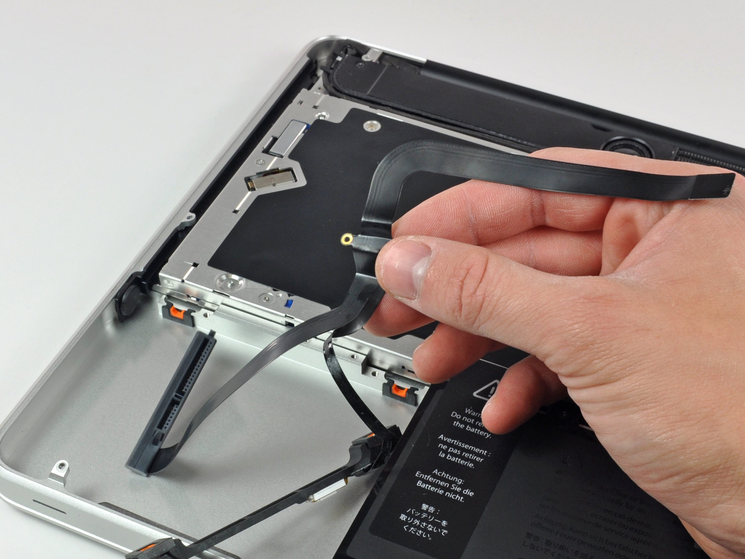

These MacBooks are renowned for problems with the HDD cable, cheap & easy to replace.
ibarnett has brought up an important point.
Replace the ribbon cable, and the original drive may start working again, just fine.
When the ribbon cable is bad, chances are no drive will be recognized -- resulting in the "?" which is telling you it can't find a drive/OS from which to boot.
You can get the part number for the cable from ifixit.com.
Either get it from them or from other online sources (other sources will probably be cheaper).
If you have an external enclosure that can hold the boot SSD, or perhaps a USB3/SATA docking station, try this:
- connect the dock or enclosure to the MBP
- try to boot that way (hold down the option key at boot)
- if you can boot right up from the external, it's probably the cable.
